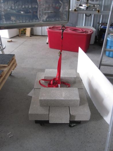

PostPosted: Thu Mar 12, 2015 6:10 am    Post subject: How to lift the nose wheel without an engine hoist Reply with quote
I bought a furniture dolly at harbor freight added center board with nice eye bolt and then added solid concrete blocks and left room to get an 1.5 inch rachet strap down to the eye bolt. this way I can pull the tail down were ever it is. Works great. I can roll it around very easy
And store it in the corner. Takes up
More room than the eye bolt in the
Concrete but more adjustable.
Just another idea that works
Geoff

I used proseal – works fine.
I do not consider it safe to use the tail tie down bolt to pull down the tail.  Remember this tie down is a light piece of threaded aluminum – that you cut the threads for.  The risk is the eye bolt pulling out and you dropping the prop and engine onto the hangar floor.  A Harbor Freight engine hoist is exceptionally cheap compared to recovering from a nose crash even if you are not hurt.  The hoist will be used at least for every annual as well when you pull the nose wheel to grease the bearings.
Carl

PostPosted: Thu Mar 12, 2015 6:17 am    Post subject: How to lift the nose wheel without an engine hoist Reply with quote
I haven’t tried it yet, but in the past some folks recommended filing a plastic tote with concrete and imbedding a hook in it. Sounds like a nice alternative to those of us without a eyelet in our hangar floor or the option to add one but can still pull the tail down.
Marcus

PostPosted: Thu Mar 12, 2015 6:29 am    Post subject: How to lift the nose wheel without an engine hoist Reply with quote
Yeah, Geoff's idea is great, and a tote would work too.
Regarding Carl's not trusting the threads, I think the threads
are plenty tough for the job. It takes less than 250 lbs
for sure to raise the nose. Depending on the way the aircraft
is loaded (you could add weight to the baggage area), I'm guessing
you can raise the nose by pulling that bolt with anywhere from
75 to 200 lbs of force max. If the tiedown can't hold that,
then we shouldn't be tying down with it, and if the tail can't
hold that, I'm not sure I'd trust the airframe.

PostPosted: Thu Mar 12, 2015 6:42 am    Post subject: How to lift the nose wheel without an engine hoist Reply with quote
One question on using proseal or any other bonding agent, what is the purpose for it? Once the plate is in place I can’t imagine it’s going to move around any given the pressures involved. Is there another benefit? The SB does not mention using anything.
FWIW the SB also recommends the use of a “ballasted tail stand” so the company does not seem to find an issue with that method of pulling the tail down.

PostPosted: Sat Mar 14, 2015 6:44 am    Post subject: How to lift the nose wheel without an engine hoist Reply with quote
On 3/12/2015 10:14 AM, Marcus Cooper wrote:
--> RV10-List message posted by: Marcus Cooper <cooprv7(at)yahoo.com> (cooprv7(at)yahoo.com)
If you look carefully you can see the concrete filled crate I embedded a hook in to winch the tail down to with a tie down strap.  Even though I have the ubiqutous HF winch, I find it awkward for lifting the nose for this particular operation.  BTW, I load the baggage compartment down with water bottles.
Kitlog - tail raising and lowering
You can also see how I used the HF wince to raise the tail and compress the donuts.

Kelly said "...They are designed to secure the tail at a 45 degree pull angle for forces the horizontal stab can generate, not a direct pull vertically or horizontally..."
Not to split hairs here, but that makes very little sense as basic physics tells us that the "45 degree pull angle" can be resolved by the summation of a horizontal and vertical components. Therefore, it matters not whether the force is applied vertically or at a 45 degree angle so long as the vertical force does not exceed any structural limitations.
According to many that have tied the tail, it takes less than 250 lbs. The force that the stabilizer can produce is certainly greater than that. Of course, the stabilizer is mounted to distribute it load, so that needs to be considered. For me, I will have no issues borrowing the brick cart idea to secure the tail when necessary.
YMMV.

PostPosted: Sat Mar 14, 2015 11:25 am    Post subject: How to lift the nose wheel without an engine hoist Reply with quote
I don't disagree, however, the method of fastening the tiedown, the direction of pull etc do matter as to determining the actual structural strength. Whether rivets are in tension or shear matters. Same for the threads.
 If one loads the baggage compartment to lower the needed force, that side is good, but you need to protect against banging the tail on the floor.
