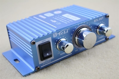

Understand. My recommendation is to start with
any sort of pre-packaged audio amplifier. One
like this would work nicely.
[img]cid:.0[/img]
There are dozens of similar devices on eBay. I've
used a bunch in various applications with good
results and value. You can power them up with a
12v 'wall wart'. In fact, if you'll shoot me an
address, I donate an amplifier and power supply
to the project.

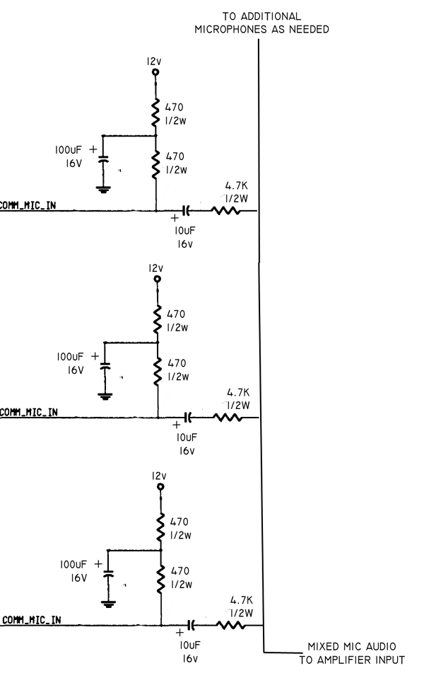

The next thing you need to do is cobble up the
interface that makes an aircraft microphone 'look'
like something found in the rest of the world . . .
[img]cid:.1[/img]
A circuit like that shown above will allow
you to bias-up and mix as many microphones
together as needed. PTT for any particular
mic can be a simple n.c. push button in parallel
with the microphone. The button shorts out the
mic unless being used. This is preferable to
putting a n.o. button in series . . . the
parallel configuration reduces the DC level
shift and resulting 'pop' you hear in the system
as any one microphone is keyed.
Headphones can simply be paralleled assuming
they're all about the same efficiency where volume
can be managed by the single control on the amplifier.
Recommended circuitry not shown is a 220 ohm, 1/2
watt resistor in series with each line out to
a headset. At worst, you may have to balance
relative audio levels in the headsets which
can be accomplished by adjusting the value of that
220 ohm resistor.
Got somebody in your group that's handy
slinging solder?

Thank you so much, Bob! That's exactly what I was hoping for.
I'm sure I can handle building the mic mixing circuit. If I used an
adjustable 1/2 watt potentiometer to each headset, what value
would you recommend - 220 ohm, or higher? Probably a stupid
question, but what type capacitors should I use - electrolytic, or?

Got the mailing address. I dug out an amplifier
and power supply. Need to find my MP3 player to
test it for functionality.
What you might consider is a volume control
at each station where a headset is plugged in.
Set the master volume on the amplifier on
the 'generous' side and let each station
set their own volume to suit.
There's some other options to consider. If
some of the stations are listen-only, you
could use contemporary headsets (10-50
ohm) for a lot less money than aviation
headsets (100+ ohms). Each station's
volume control would be a 50-ohm,
wire wound potentiometer.
http://tinyurl.com/nqruvxd
The capacitors shown are all electrolytic.
Any time you see a "+" sign associated with
the symbol, that tells you that it's some
form of electrolytic. I've got all those
parts in my sand-box-bins. I'll include
a kit of loose parts with the amplifier.
