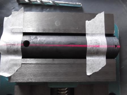

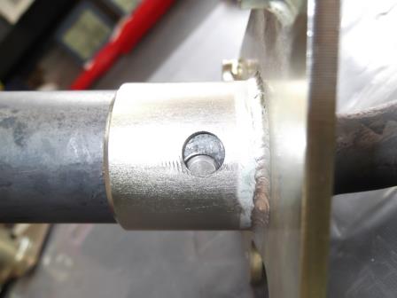

Have just tried fitting the brake caliper mounting plates MG02 to the main gear legs and found that the holes for the AN5 bolts do not align.
One leg is quite close and would probably go after a bit of fettling, but the other leg is half a hole out.
Has anyone else had this problem?
I have checked the alignment of the drilled holes on the problem leg and both the mounting bolt hole at the top of the leg and the axle hole are vertical when the leg is laid on a flat surface, so that's ok.
The problem looks like the hole in the axle for the torque plate mounting bolt has not been drilled on the centreline. This can be seen in the second picture.

I HAD THE SAME THING HAPPEN TO ME AND FOUND OUT THAT THE SOCKET WERE DRILLED THE WRONG WAY. HAD TO BUY NEW SOCKETS
