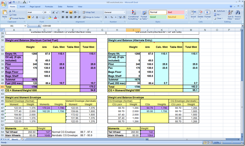

We don't have any drawings so I was wondering if someone out there could give me the moment arms for pilot, passenger, fuel and baggage so I can do some loaded CG calculations to keep our Feds happy??
Our flight limitations sheet lists the forward limit as 83.2" and the aft limit as 93.9"

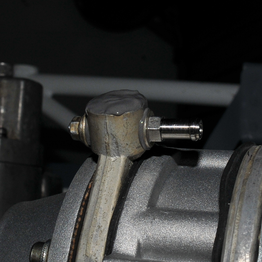

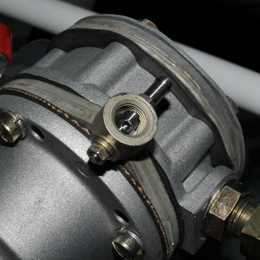

Yes mate, fuel pump clearance is often an issue on RV-4 and Rocket aircraft. I machined and installed an overflow tube (below), turned the open hole inwards, JB Welded the top and bottom of the shaft where it passes through the outlet and also JB Welded a flat disc in the hole then smoothed off after it set. After all, this part's only function is to limit fuel passing into the crankcase if the diaphragm should rupture.
[img]cid:A1E693E6-6B11-472B-B5D8-B6010F0B62EA(at)Home[/img]
[img]cid:3E1FBA0C-2D79-4AA7-9415-24DD20732955(at)Home[/img]
I have an actual formal W&B for a mate’s F1, but I need to check with him that I can release it … t’was a paid service. Will let you know ASAP.

I have a Harmon Rocket 2 that I extensively rebuilt and did a full weight and CG calculation for. I will attach the spreadsheet I used (borrowed from another HR2 guy) that I believe is accurate. My HR2 is a bit lighted at the nose because I replaced the metal Hartzell prop with an MT two-blade prop. Also, the prop governor is a little lighter that the one used with the Hartzell. All told, I probably saved 15 pounds at the nose. You might be interested in two other weight and balance products: the one included in the Foreflight Application for iPad/Phone and another titled "CG Finder Plus". I use both/either and they are very accurate.
On my aircraft, I have the following arm/weight combinations:
Plane: 85.14" / 1229 pounds
Pilot:   105.0" / 210 pounds
Fuel:   86.50" / 252 pounds
Passenger: 136.0" / Varies
Fwd Baggage: 156.0" / Varies ( I split the baggage area for weight/balance. The "Fwd" area is in front of and above the battery. The "Aft" baggage areas is behind the battery and all the way to the aft bulkhead.)
Aft Baggage: 187.0" / Varies
I also included parachutes:
Fwd Chute: 114.5" / 15 pounds
Aft Chute: 145.5" / 15 pounds
The research I have done also indicates a maximum weight of 2000 pounds and a CG range of 86.76" to 97.40".

voltar(at)vx-aviation.com
PostPosted: Thu Mar 05, 2015 4:47 am    Post subject: ZK-TWU gear leg update Reply with quote
The only authority I used was Van's wing CG spec http://www.vansaircraft.com/pdf/RV4wb.pdf
All of my arm measurements are actual, not derived from another a/c.
Your forward cg spec is outside of Van's limits.
Just sayin. If you've flight and landing tested to your limits you are good to go. I know that single place, I like to carry ballast for 3-point landings. The F1 gear is mounted farther fwd and can handle the fwd cg for landings. I Don't recommend using F1 data for Harmon, though.
