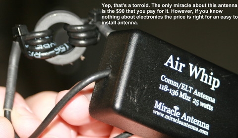

those beads over the coax. Some months ago
I cited a product offered by Miracle Antenna
Company out of Canada called the "Air Whip".
Aircraft Spruce offered this product for a time
and it's still listed in their European catalog
http://tinyurl.com/mgm26yh
. . . but I understand the gentleman who built
and ran the company died in 2012. I'm not sure
the company is still in business. But the Air
Whip was an EXCELLENT example for effectiveness
and value of a 'balun'. That red heat shrink
covered lump in the coax feeder was identified
for us by a writer who disassembled an earlier
version of the Air Whip
[img]cid:.0[/img]
Yup, there it is. A ferrite torroid. Not a string
of torroids but a single device with 7 passes of
coax through the center. The inductance offered by
such a technique varies with the SQUARE of the
turns on the core. By passing the coax through the
core 7 times, the net effect is 49 times as effective
as a single pass thorough one core.
Further, this antenna's design DEMANDS the inclusion of
this de-coupling technique . . . which is not a BALUN in
the purest sense although it has the appearance of one.

physics. Analysis of single beads on the g.s. antenna,
reveals usefulness on the same order as carrying a
couple more pounds of pressure in your tires.
