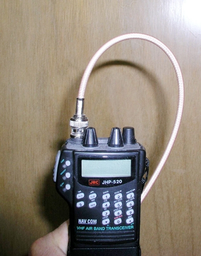

At 22:19 2015-02-23, you wrote:
Is there an efficient, elegant way to connect an external aircraft comm antenna to a handheld radio in the event of failure of the panel-mounted radio that the antenna is connected to? I know that I could run the cable within reach of the pilot, with connectors inline to break the connection to the panel and connect to the handheld unit. That's what I did on my first homebuilt. However, I envision a panel-mounted male BNC connector that could possibly be used to connect the handheld without physically disconnecting the failed radio, providing that radio is switched off. If this is possible, I'm wondering if some kind of antenna switch or splitter would be necessary. I'm talking about the antenna only serving one radio at a time. This is very possibly a dumb question.
Since the h-h is backup for a failed radio,
only ONE antenna can be made to service both
appliances. One of my favorite 'back up' antenna
arrangements suggests arranging a coiled-up
excess of comm antenna feed-line to be situated
in a handy but out of sight location. A BNC cable
male/female joint on the panel-radio end of the
coil. Of course, this excess cable should not
be retained in a manner requiring more than
your fingers to access, break the joint and
uncoil it.
Should it become necessary to put the h-h
into service, you can string out the coax
and hook it to the radio.
[img]cid:7.1.0.9.0.20150224100526.02004028(at)aeroelectric.com.0[/img]
Unfortunately, this particular arrangement is a
bit un-graceful.

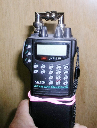

Consider this . . .
[img]cid:7.1.0.9.0.20150224100526.02004028(at)aeroelectric.com.1[/img]
A pair of right angle adapters can be used to
bring the antenna coax down the back of the
radio such that the whole becomes more like
a microphone. If your BNC cable male on the
feed-line is already a right-angle connector,
then you only need one adapter to get the 180
degree, tight bend.
