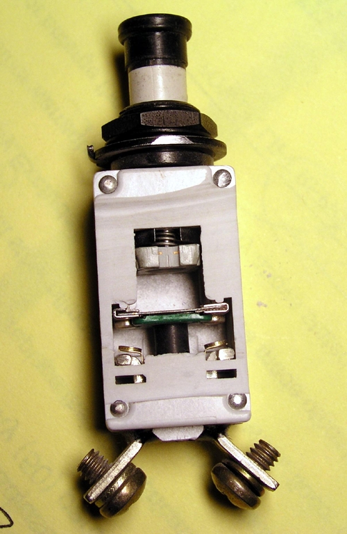

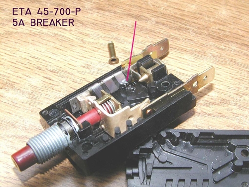

While the legacy, pullable mil-style breaker
[img]cid:7.1.0.9.0.20150412195958.0038fac8(at)aeroelectric.com.0[/img]
. . . will grunt the ov trip thousands of times without
breathing hard, some 5A breakers won't make it to first
base . . .
[img]cid:7.1.0.9.0.20150412195958.0038fac8(at)aeroelectric.com.1[/img]
This little feller burned in two on the first trip . . .
[img]cid:7.1.0.9.0.20150413082505.03f18ff0(at)aeroelectric.com.2[/img]
base . . .
[img]cid:7.1.0.9.0.20150413082505.03f18ff0(at)aeroelectric.com.3[/img]
This little feller burned in two on the first ov trip . . .
  base . . .
