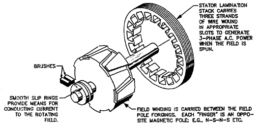

The closest this program comes to 3D is the isometric drawing mode which is a quasi 3D . . . used extensively in catalog drawings and exploded view assembly drawings. A process that is easy to learn and quite useful. The 'solid' drawings in the 'Connection are isometrics I did in AutoCAD . . .
[img]cid:.0[/img][/b]

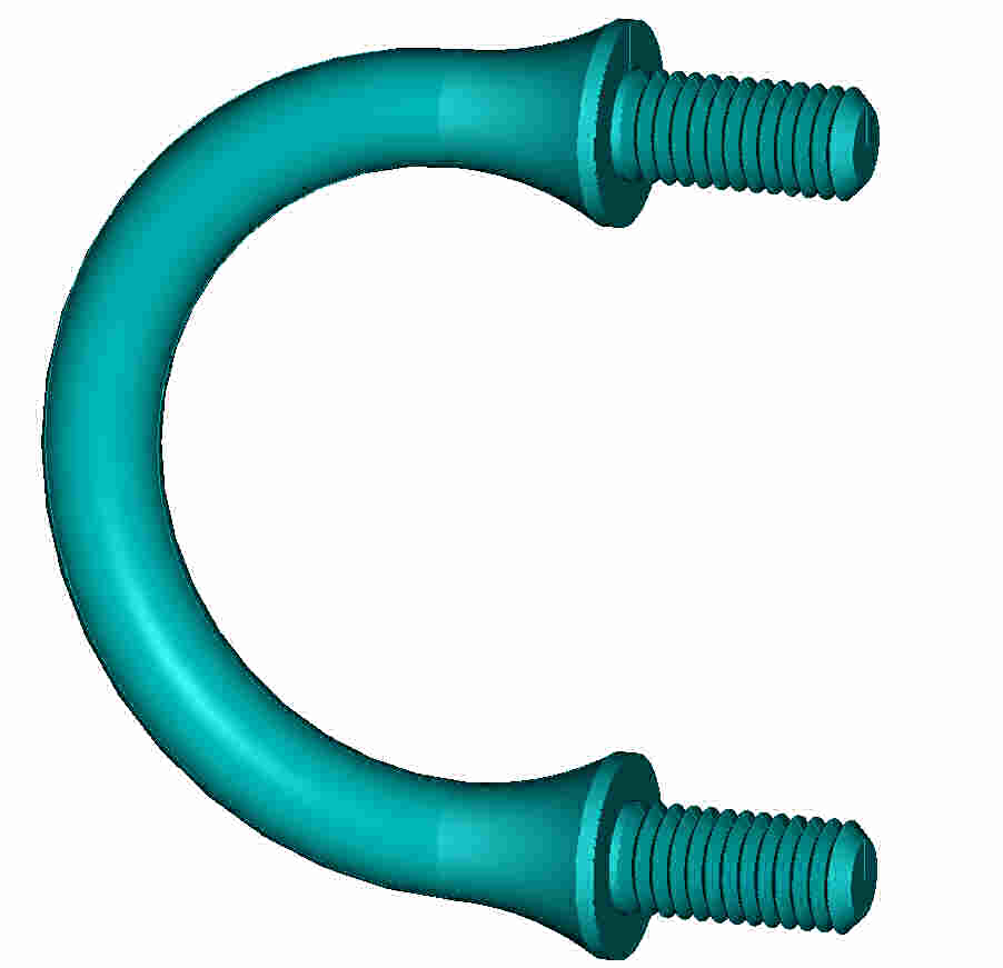

I was always converting files and doing special jobs using DesignCAD. Furthermore tiny little DesignCAD had a tiny button marked 3D...and that big CAD program could only dream about having a 3D capability. Now of course Cadra has vanished.
TurboCAD is similar and better in some areas. Some users do some things in DesignCAD and other things in TurboCAD on the same drawing. Amazing.
DesignCad is a true 2d/3d program see attached solid model of my switch guard. But you can buy copies of Solidworks on Ebay for cheap. It in in some ways more up-to-date.
