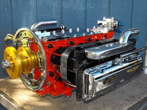

Hi all! Sam here in Idaho. I am currently building a MKIII Extra.
My engine of choice is a converted Corvair Engine that I built for a
different project. There are several pros and cons but the main reason
for using a Corvair is price.
 Filesize:  36.78 KB
 Viewed:  31649 Time(s)

Sfrill, Great looking engine, but you need to consider its weight. Putting a 200 lb.+ engine in a MkIIIX reduces it to a single passenger airplane. I've flown the IIIX at 1280 lb. Very poor performance. My peronal recommendation is to not fly it at greater than 1100 lb. You also need to consider the strength of the rear portion of the fuselage truss. The MkIII was designed as a +4g airframe. Doubling the design engine weight seriously compromises the aircraft's designed strength margin.
http://forums.matronics.com/viewtopic.php?p=438562#438562

powered with a Corvair.
People assume that this engine is very heavy.
In reality, a running aircraft converted Corvair
is only 30 LBS. heavier than a 912.
Sam
