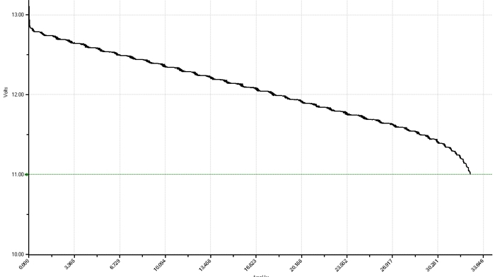

Just put a new battery in Dr. Dee's little red Saturn. Just for grins,
I sucked out most of the electrons in its off-the-shelf condition and
got this plot . . .
[img]cid:.0[/img]
With a 5A load, you can see that it started out a closer to 13 volts and tossed
in the towel before it about 11 volts . . . i.e. an average output of 12 volts.

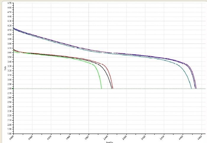

Now comes the lithium family of cells. If you charge a stack of 4 cells
to the maximum rated charge voltage of 4.2 volts per cell, then you'd
have to do it in a 16.8 volt system.
[img]cid:.1[/img]
Referring to the family of curves above, the 16.8 volt operation
gives you a "15 volt battery". But put the same array of cells
into your "14v system" tuned to lead-acid chemistry and you get a
"13.5 volt battery" while giving up about 1/2 its max rated
chemical capacity.
got this plot . . .
[img]cid:7.1.0.9.0.20150216081041.010c09c8(at)aeroelectric.com.4[/img]
in the towel before it about 11 volts . . . with an AVERAGE output of 12 volts.
have to do it at about 16.8 volts. We might call this a '17 volt system.'
[img]cid:7.1.0.9.0.20150216081041.010c09c8(at)aeroelectric.com.5[/img]
chemical capacity.
