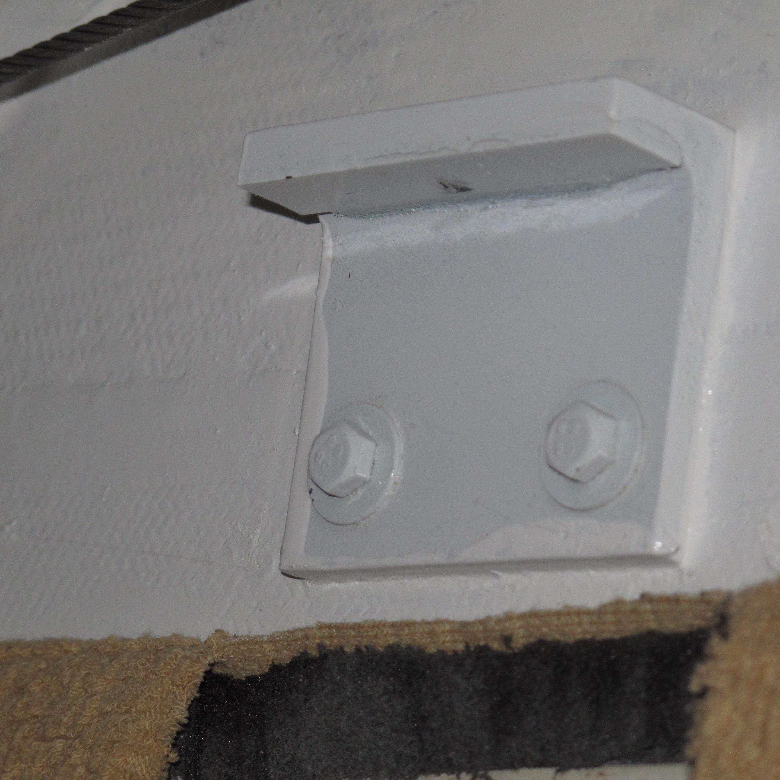

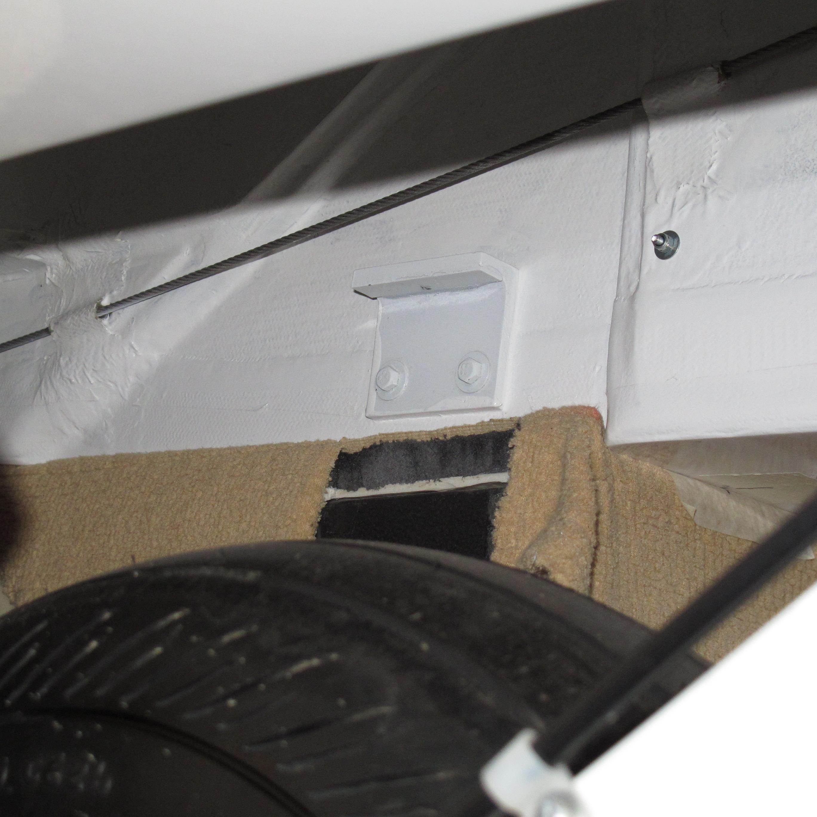

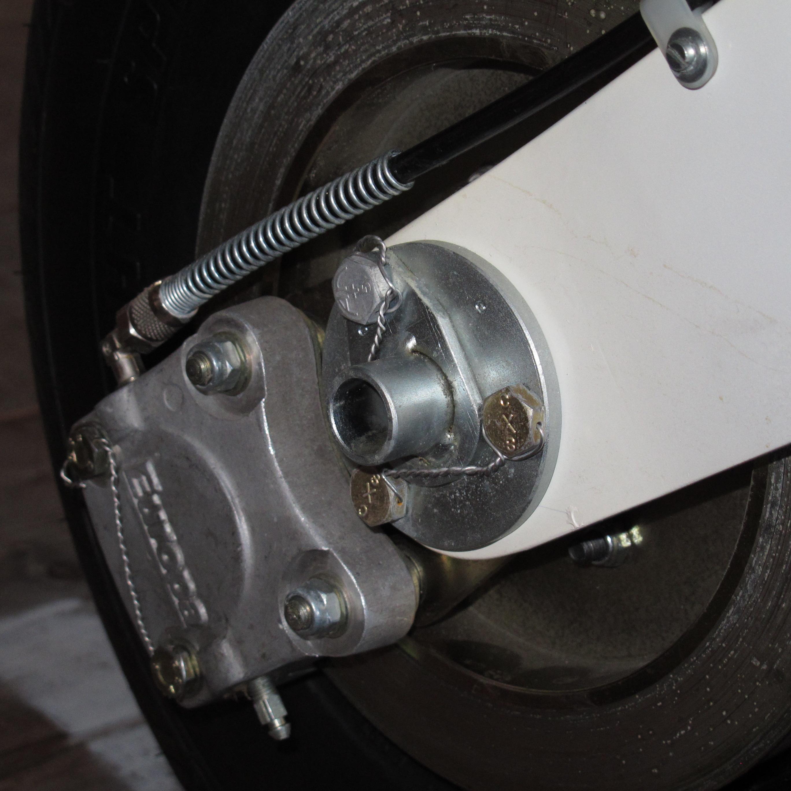

I added short pipes on both sides of the wheel axle. See attached picture. The pipes stop the up movement of undercarriage when they hit the two aluminum brackets mounted inside the wheel well (sorry, no picture, the A/C is out in the hangar). Reasons for adding the two pipes: Firstly they reduce the torsional forces applied to the sidewalls of the wheel well when the undercarriage hits the stop brackets, because the horizontal parts of the brackets are much shorter compared to the solution with the swinging arm hitting the brackets. And secondly the brackets don't interfere with the brake hose.
Regards, Alfred Buess

Hi Alfred and thanks for your suggestion and picture. I agree this could be a more elegant solution than my 'arm stop' idea, but i would be interested to see the reinforcements used in the area of the fuselage floor/tunnel your tubes contact - another picture perhaps?. Essentially these tubes and their load-bearing structure could carry maybe 1-1.5 times the whole mass of the loaded a/c (static mass + momentary inertial loading due to runway surface-induced 'bumps' and some component of the vertical inertia due to vertical velocity of landing the a/c) in a wheels-up landing, so with the resultant forces concentrated onto the tube-end areas, the structure they touch will need to be quite capable.

Here are three additional pictures showing the aluminium bracket and the wheel tube on the brake side of the wheel. The bracket is bolted to the tunnel structure that was reinforced with some BID. I made the up stop mainly to prevent the wheel from getting stuck in the tunnel (hitting the brake master cylinder) when being retracted in a snappy way. I am not sure if it is strong enough to hold the wheel in case of a wheels up landing.
