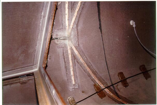

Originally I made an ELT antenna from copper tape, copying the Bob Nuckolls design that was in Kitplanes many years ago [gee, it was a long time ago now I think back - - about 16 years or so]. The antenna had a dipole centered on 121.5, and also a dipole for 243 on the same centre point. Because of the respective wavelengths these two dipoles function independently, even though they are physically connected at the centre.
The copper tape extends around one side of the fuselage right behind the baggage bulkhead and is glassed over to secure it. The fact that it is in a curve makes virtually no difference to the performance, except that the element lengths might be a fraction shorter. I remember trimming mine with an SWR meter to get the best match at 121.5. It required about 1/2 inch trimming off the ends to get the match exactly ring, with an SWR about 1.2:1 from memory.
I have a photo of the installation I can email to you. Just need to find where it is.

Here is the photo of the ELT antenna. Simple.
Brian

Looks amazingly like what I have for ELT. Must have been looking at the same plans. Thanks for the picture.
