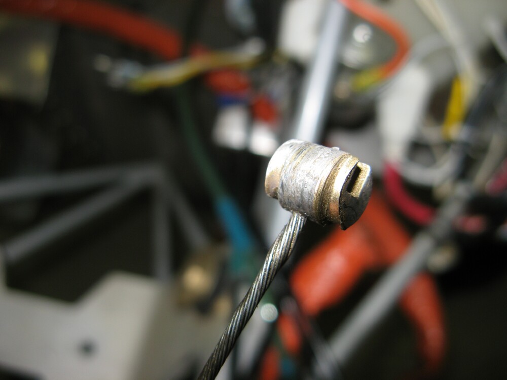

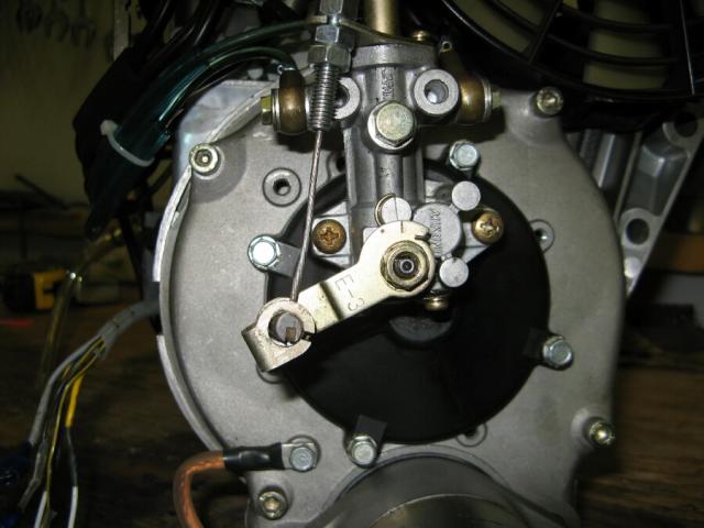

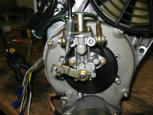

This 503 came from the factory without oil injection. At 80 hours I installed an injection system. The engine now has 136 hours so only 56 hours on this cable. You can see it is worn about 1/4 of the way through the barrel swedge on both ends where it contacts the oil pump lever. The pump lever is not worn at all. I noticed the swedge is brass. Too soft??? I have lubed it with LPS about every 10 hours.
The engine is on a Kitfox so I had California Power Sports make a cable with the 503 oiler swedge on the pump end and a barrel swedge to fit the Kitfox throttle reverser bellcrank on the other end. I think I gave them measurements either too short for the inner cable or too long for the outer cable.
I had to put both lock nuts on the adjuster below the bracket as shown to make the line on the lever line up at 3000 rpm. This caused the cable to not pull straight up on the lever at full throttle as shown in the photos. Could that be my problem
I really like the convenience of the injection and it is supposed to be better for the engine but this is no good. Anyone else have this problem or have any ideas. I called CPS and they do not custom make cables anymore.
I iknow this is not a Kolb but I have had better luck asking two stroke questions here. On the Kitfox forums if you don't have a 912 you might as well not show up at the dance on Saturday night.

Just looking at the top picture, it appears that the bracket is not properly aligned with the pump arm. Why not either twist the bracket a bit to line up, or fabricate a new bracket that puts the fitting in a better position?
Then you need a new end fitting, you can get one from CPS, I noticed they have 2 sizes, a smaller one for the 582 and a bigger one for the 503.
Looking at the close-up of the swedge, you can see where the solder has run up the cable for about 3/4". That will certainly retain it, but also make the cable stiffer. There is a foolproof way to solder a swedge end on without a solder pot, and the solder does not run up the cable as far.
The swedge end will typically have the cable hole on one side the exact diameter of the cable and it will be cut off flush with the surface. That is your entrance hole, the cable enters the swedge from that side. The other side has the hole somewhat flared or countersunk and also slightly larger in diameter. That is your exit hole. If it is not slightly oversize or countersunk & flared, make it so. Just a little bit, it doesn't take much.
With the cable extending slightly from the exit side, take a rib stitching needle, ice pick or similar, and thoroughly rat tail, unweave and debraid the cable, you goal is to physically enlarge the diameter of the cable so that it cannot pull back through even if you didn't solder it. You will be surprised how easy and effective this is. Now solder it, and you ought to see a bit of the solder flow back out through the cable on the entrance side. What the solder is doing is making it impossible for the steel cable to compress & get any smaller. The adhesion of the solder to the swedge is now no longer the primary securing method, it is now complimentary to the physical size difference between the cable & the swedge. Clean up the excessive rat tail by taking a Dremel wheel and trimming the rat tailed exit end back smooth with the swedge.
Now you have a cable that is oversized on its exit side, and cannot be compressed & pulled back through a tapered and smaller hole. Plus it is still soldered to the swedge anyway. Using the solder pot method, the hole and the cable are a constant diameter, and rely entirely on the strength of the solder joint, in which case a solder pot is mandatory.
Food for thought, worth what ya paid for it.

Thanks for that tip on soldering the swedge Richard! I am going to order one of those stainless steel swedges from Lockwood and do that. I feel a lot better about getting this done now.

I only ever did this with brass. Did not know that you could solder anything to stainless steel.

I don't know how the fittings are connected to the Rotax oil pump but most cable fittings rotate so that there is little or no ware on the soft cable ends or bending of the cable. Could you consider changing the attach fitting?

Soldering stainless steel requires a good flux.    I did some experimenting..if I fluxed the SS cable and used a soldering iron without much success....   melted some solder in a half inch copper cap and dipped fluxed SS cable in the melted solder and it worked quite well

I was thinking of soldering the steel cable to secure it in the swedge using your method. The swedge is the only stainless part.

Tom, To solder the stainless steel you have to get through the oxide layer on the stainless. Most of the fluxes to accomplish this are acidic. The flux will wick up the cable and is difficult if not impossible to remove. On top of that you're going to have to get both parts red hot. Both operations are going to be bad for the cable.

Well, I guess I'll go back to brass and hope for the best. I ordered 4 brass swedges so I can replace them every 20 hours or so I guess.
