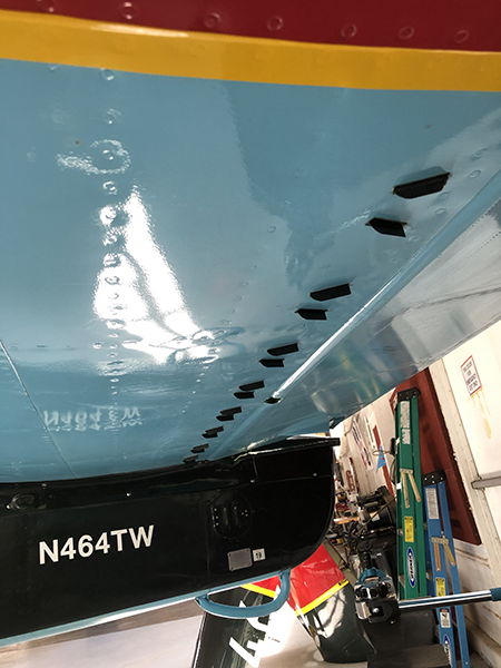

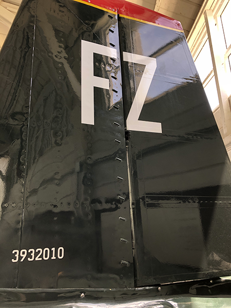

PostPosted: Sun Apr 07, 2019 6:32 pm    Post subject: Flying at the edge of the envelope, VGs whistle. Reply with quote
Here are the images of the VGs on the vertical stabilizer and the underside of the horizontal stabilizer. Their spacing for these is less critical and Charles White provides a template for placement. When you get these, suggest having a handful of spares just in case one comes off.
Hope this helps,
Warren Hill
N464TW
Mesa, AZ
[img]cid:18637CCF-6BB2-4968-9F47-0B7973EE9612(at)Home[/img]
[img]cid:AA4D20EB-6CD5-4F05-A847-9830D808235E(at)Home[/img]
