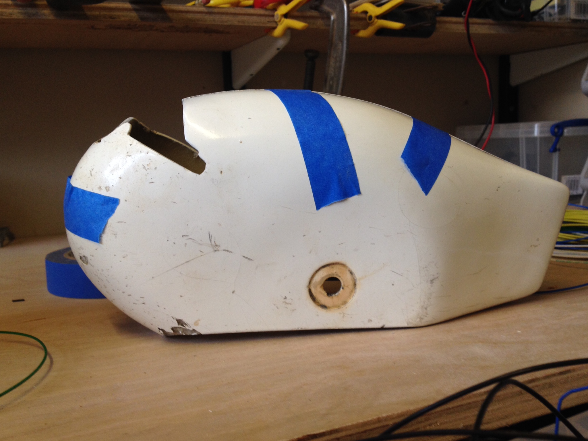

PostPosted: Wed Jan 28, 2015 5:54 am    Post subject: Tail wheel fairing Reply with quote
Fred here are pis of my old one

PostPosted: Wed Jan 28, 2015 11:19 am    Post subject: Tail wheel fairing Reply with quote
David…Thank you so much for sending this…your pix shows clearly the extent to which the fairing needs additional cutting away in order to accommodate the Singleton aluminum fork.
All...I don’t mean to stretch my luck, but I’m going to ask if anyone has a pix of the tail wheel fairing in conjunction w/ the Singleton Mod as it appears when installed on the mono wheel?

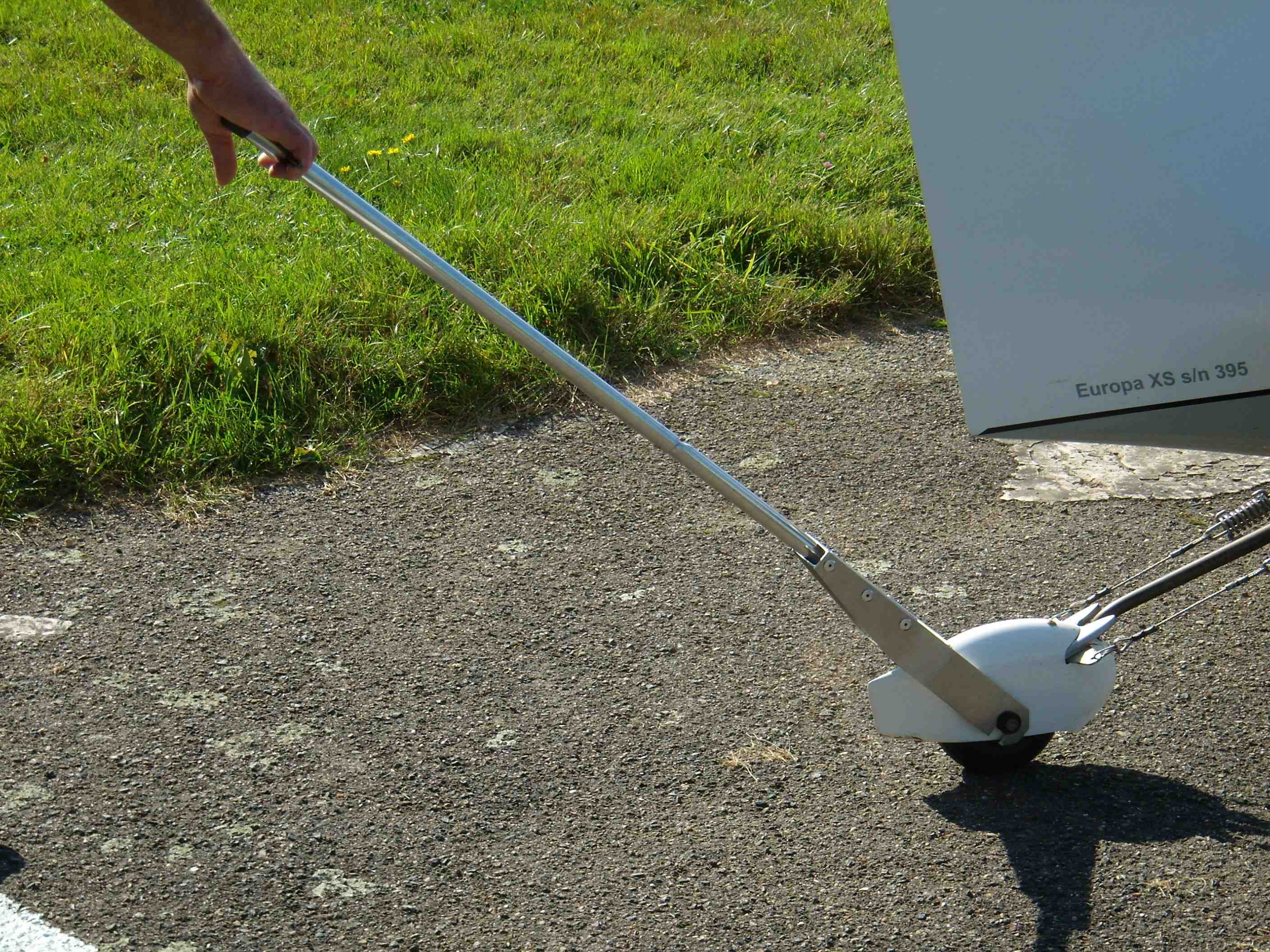

PostPosted: Thu Jan 29, 2015 12:32 am    Post subject: Re: Tail wheel fairing Reply with quote
Fred,
Attached is a picture of my tail wheel. This is the standard XS tailwheel with the addition of a home made copy of the Singleton Y stop. I have since removed the fairing as it has been damaged very quickly by projection of stones when flying from dirt strips. No measurable effect on cruise performances.

PostPosted: Thu Jan 29, 2015 10:05 am    Post subject: Tail wheel fairing Reply with quote
On Jan 29, 2015, at 12:32 AM, Remi Guerner <air.guerner(at)orange.fr (air.guerner(at)orange.fr)> wrote:
Thanks Remi…it sounds like your experience is a common one…perhaps the best use of the tail wheel fairing is to keep it in a pouch in the baggage area and install it when being judged at an airshow or for picture-taking.
Not surprising that you’ve found it to have “no measurable effect on cruise performance”…on an airframe as sleek and slick as the Europa, I suspect that only major improvements such as Nigel Graham’s marvelous cowling will show measurable effects at cruise.
On the other hand, in the spirit of the definition of an airplane as “20,000 compromises flying in close formation”, perhaps every little bit helps.
