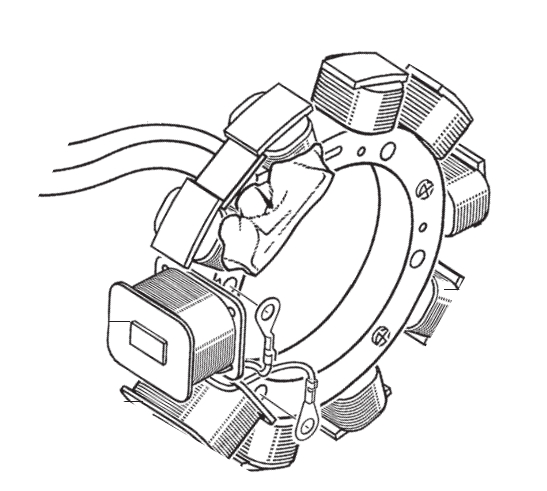

PostPosted: Sun Jan 25, 2015 6:18 pm    Post subject: Power Generation without Battery? Reply with quote
At 18:16 2015-01-25, you wrote:
Chris,
My mistake, I should have read your first post more closely. You do intend to use the SD-8 dynamo.
The Rotax 912i fuel injected engine has two dynamos, one for the engine and one for the rest of the aircraft. The ignition and fuel pumps can also be powered by the other dynamo if necessary.
The last time I dug through the MM on a 912, a
constellation of windings on the PM alternator
stator core were defined as follows:
[img]cid:.0[/img]
4 each, trigger coils for spark timing of the
8 plugs in pairs (waste spark). These
will be a low voltage, low energy
signal to the ignition modules.
2 each, capacitor charging coils, one for
each module. These are moderate energy,
high voltage windings that charge a
capacitor with each pass of the magnet.
This few hundred volts of capacitor
charge is stepped up in coils to the
killovolt levels needed for plugs.
1 each, tachometer signal coil. Another
low voltage, low energy signal generator
for an electronic tach.
1 each, PM alternator coil. High energy, high
current in the 250W class. This is the
only winding available to drive any
sort of rectifier-regulator to operate
ship's electro-whizzies.
All other windings are separate and dedicated
to their respective tasks thus making ignition
systems completely independent of the power
generation system.
Some Rotax installations include aa SECOND,
optional belt driven alternator in the 40-55A class.
This second alternator has been teamed with
the integral PM alternator in a Figure Z-13/8
configuration on several OBAM aircraft . . .
I've seen some pad driven alternators on
Rotax engines . . . in the spot for
vacuum pumps. But this pad is slow and
I don't think THAT particular #2 alternator
was very practical.
In any case, only one coil of eight on the
back of a Rotax 912/914 generates power
for ship's electrical needs.
 Filesize:  106.67 KB
 Viewed:  26984 Time(s)
