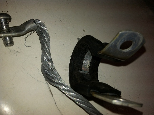

I'll look for a contact ribbon.  I found this picture.  It makes sense.
http://www.interfast.ca/images/115.jpg

I believe that you will find, if you remove and inspect the Adel clamp, there is a thin metal ribbon woven through the rubber in such a way that it makes contact with the fuel line and the metal structure of the clamp.  This will, in fact ground the fuel line.
Roger

Dave Saylor
Joined: 11 Jan 2015
Posts: 211
Location: GILROY, CA
PostPosted: Sat Jan 17, 2015 10:24 am    Post subject: Insulated ground cables? Reply with quote
​OK, I understand that using a tight padded clamp will preserve the clampee​.  I've repaired much damaged from loose clamps and ty-wraps.
I still don't get, unless it's a conducting clamp, why a bonding strap would be well insulated at one end of the circuit.  They're not providing any mechanical connection.  Purely electrical so far as I can see.
I may know a lot more after looking closer at the clamp.
--Dave

PostPosted: Sat Jan 17, 2015 11:19 am    Post subject: Insulated ground cables? Reply with quote
Any sort of 'conductive' clamp can serve no better purpose
than to mitigate potential differences at LOW current.
I.e. static and maybe noise in radios generated by
itty-bitty arcs due differences across separate airframe
grounds . . . recall that any electrical connection worthy
of the name is gas tight. Lots of pressure, welding, soldering,
crimping, or other joining process intended to exclude
moisture and preserve a BOND. There may be a constellation
of simple-ideas that speak to the utility of 'mildly conducive'
Adel clamps; but not that I've heard/read/observed in my travels.
If design goals for airplane include some level of
survivability to lightning strike, then conductive
bushings in a clamp will not be part of that particular
hardening process.

PostPosted: Sat Jan 17, 2015 11:44 am    Post subject: Insulated ground cables? Reply with quote
Test it to see if there a connection.

PostPosted: Sun Jan 18, 2015 11:55 pm    Post subject: Insulated ground cables? Reply with quote
On 17 January 2015 at 21:18, Robert L. Nuckolls, III <nuckolls.bob(at)aeroelectric.com (nuckolls.bob(at)aeroelectric.com)> wrote:
--> AeroElectric-List message posted by: "Robert L. Nuckolls, III" <nuckolls.bob(at)aeroelectric.com (nuckolls.bob(at)aeroelectric.com)>
  hardening process.
Hi Bob et al.
The fuel line is conductive aluminium - why would there be a static build up, unless it were isolated completely from the rest of the airframe by rubber fittings at every support as well as rubber hoses connecting it to the rest of the fuel system? Surely no matter where the pipe is grounded (by connecting it to the fuel tank, gascolator, fuel selector switch or similar), that would dissipate any static build up along the entire length of aluminium piping and anything else connected to it by the AN fittings? I am particularly intrigued by this having _just_ ordered 50' of aluminium fuel piping to refit my Citabria's continuously perishing rubber fuel hoses.
Could it not be as a mechanical restraint in the event of an accident to ensure that when the airframe crumples the pipe bends in a particular fashion to reduce the risk of kinking and spraying fuel all over a fire...?
Etienne
PostPosted: Mon Jan 19, 2015 5:55 am    Post subject: Insulated ground cables? Reply with quote
Hi Bob et al.
Not a static built up WITHIN the tube, but static
currents circulating WITHOUT wherein two conductive
entities are not electrically bonded to each others
and some 'discharge' occurs between them. This is
not a fire safety kind of issue but purely one of
potential noise.
Admittedly, this is an stretch in the extreme to
apply this kind of reasoning to 99 percent of little
airplanes . . . but there are folks who have listened
well to their teachers with experience in high performance,
high altitude and perhaps weapons-grade machines
wherein the slightest risk for mission failure was
treated as a national security issue.
The question that Dave was pondering is probably
not germane to any airplanes that we're interested
in . . . and the narrative supporting the practice
for what he is observing is not readily available
to us.

PostPosted: Mon Jan 19, 2015 5:58 pm    Post subject: Insulated ground cables? Reply with quote
Here's a picture of the clamp.  It clearly has the contact patch that Roger described.
The fit is not at all tight.
It's cabled to the wing skin under a nacelle.  The cable attaches to the skin about 1.5" from the bulkhead fitting supporting the tube...
Thankfully, if the tube comes completely disconnected at each end from it's fittings, it still has a path to ground...(kidding).
I still don't know the original intent, but the owner is satisfied that the fuel lines are grounded.  Mission accomplished.
Thanks for all the input,
--Dave
[img]cid:ii_14b0502a318424d5[/img]
 Filesize:  449.35 KB
 Viewed:  8592 Time(s)
--Dave
