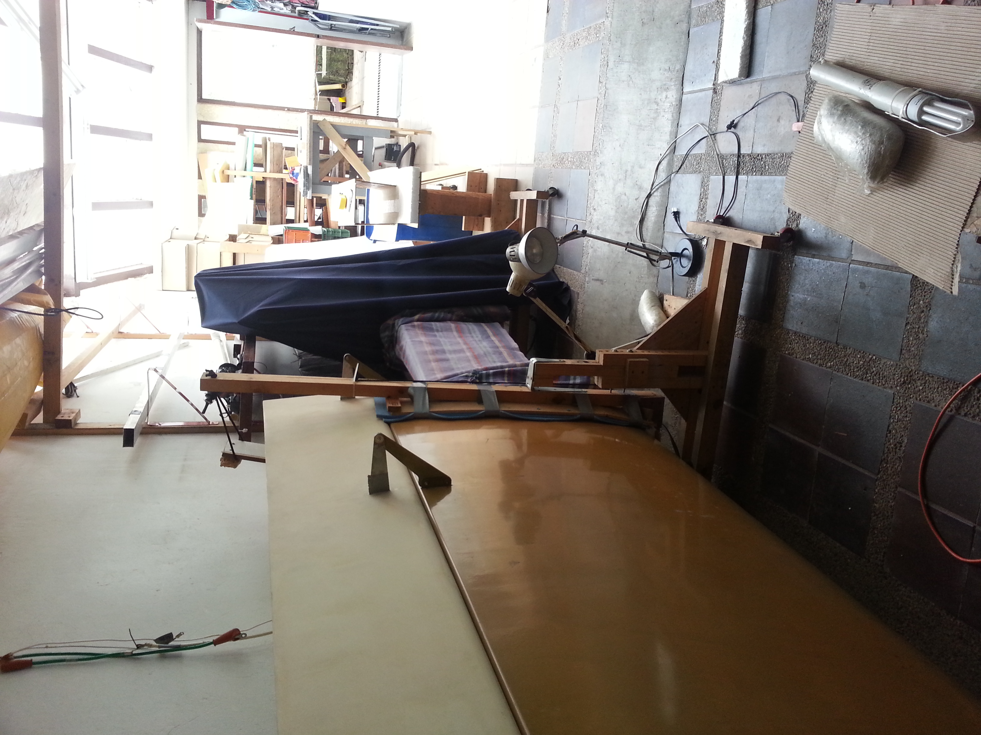

wdaniell.longport(at)gmai
PostPosted: Sun Jan 11, 2015 10:55 am    Post subject: Removing and Attaching Wings Single Handed Reply with quote
My rather unsighly but effective set up.  There are two pretty much the same per wing...I copied them from a much neater version but I dont remember who.
Will On Jan 11, 2015 10:23 AM, <alan.twigg775(at)gmail.com (alan.twigg775(at)gmail.com)> wrote:

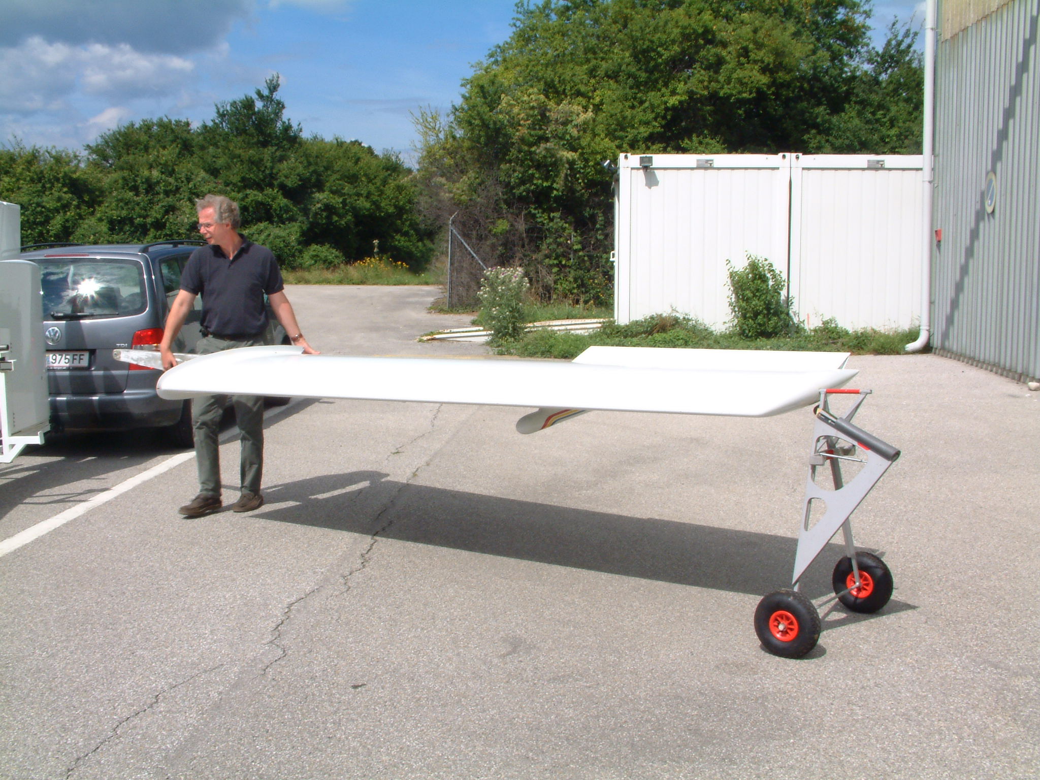

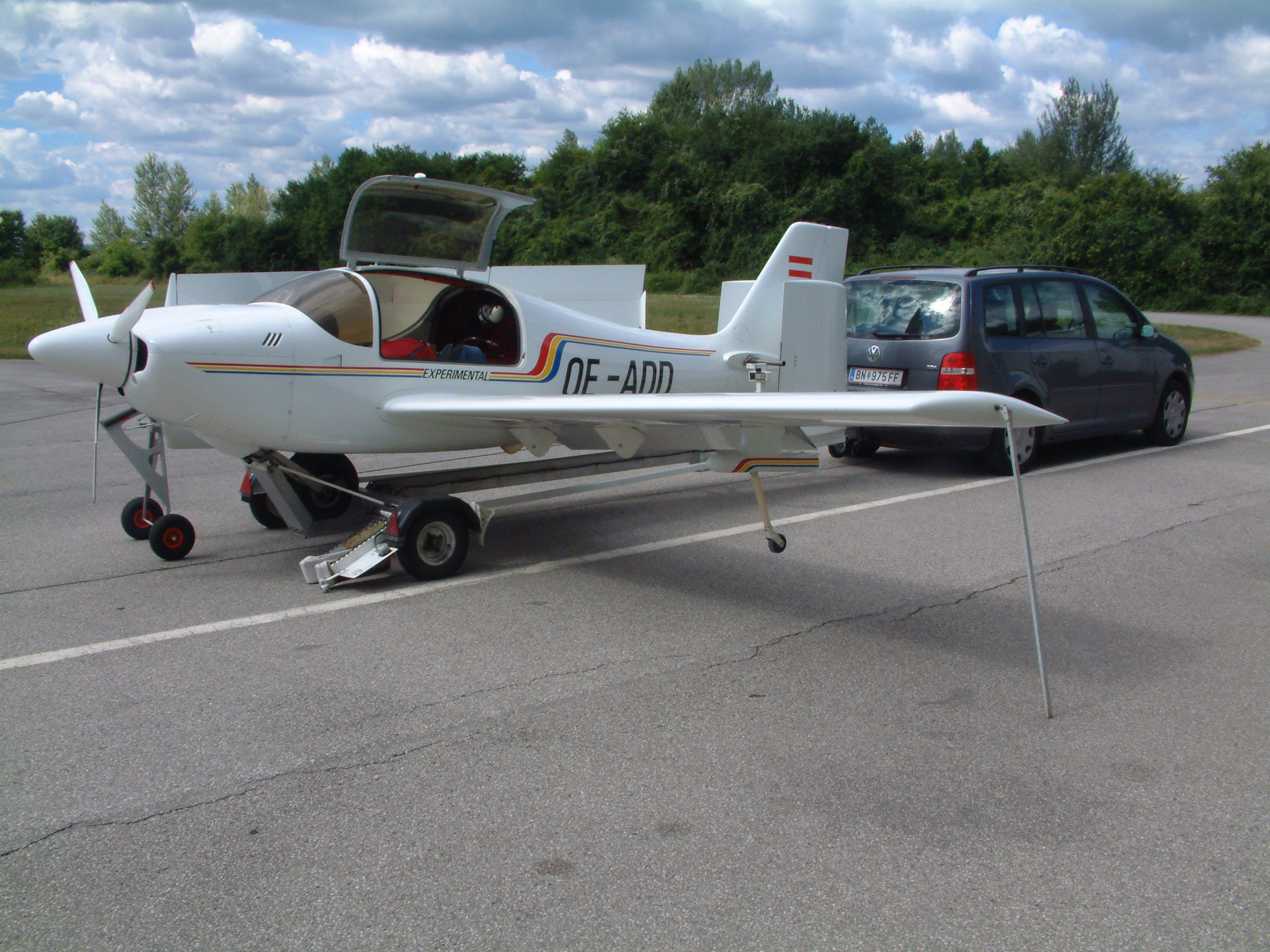

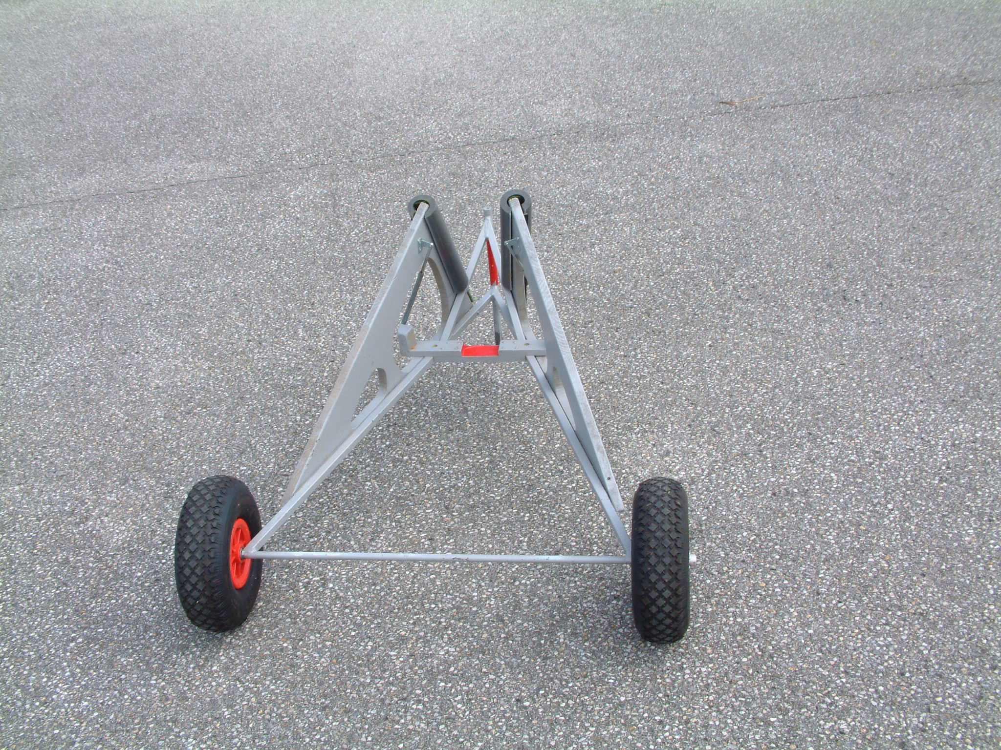

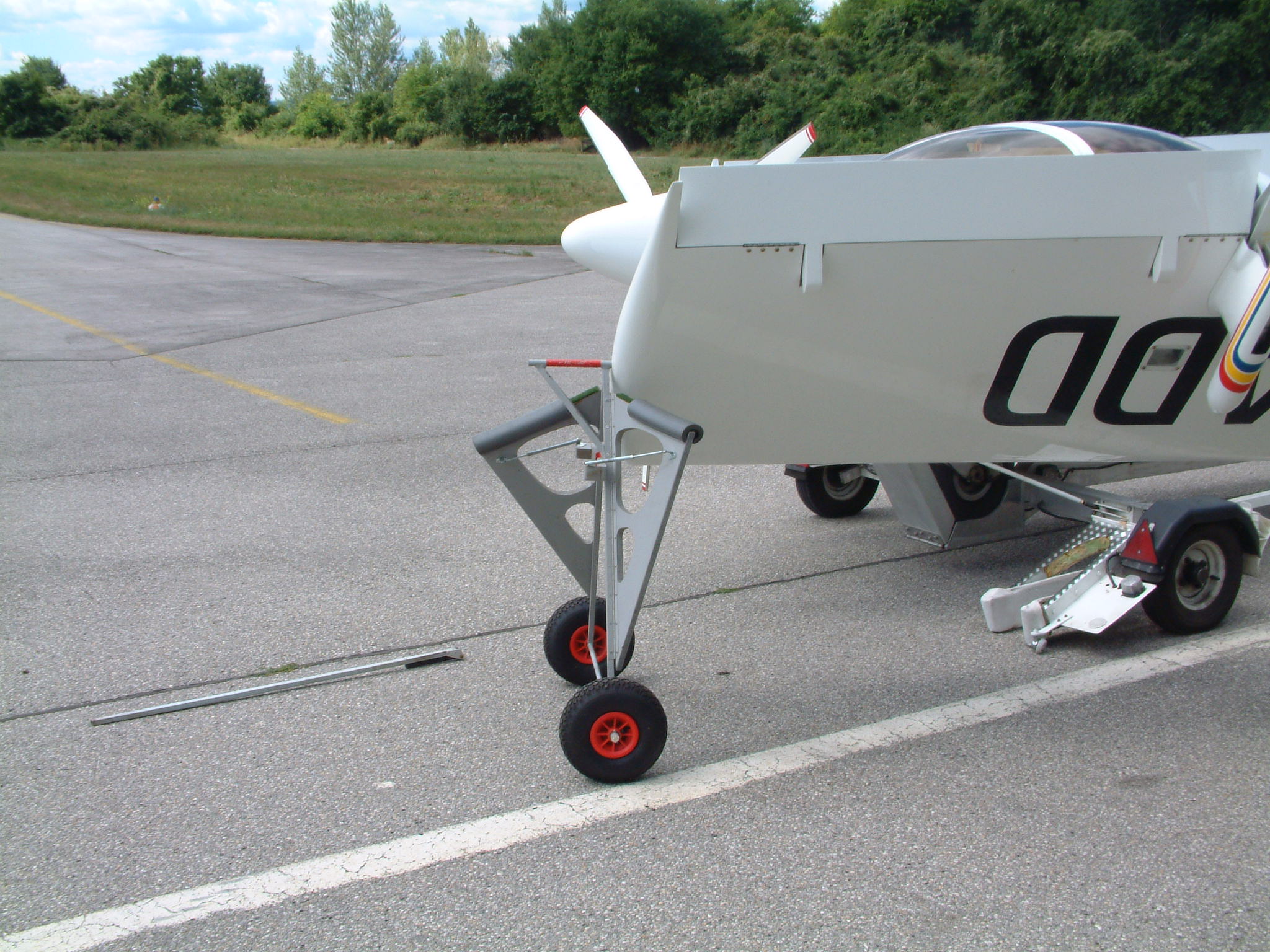

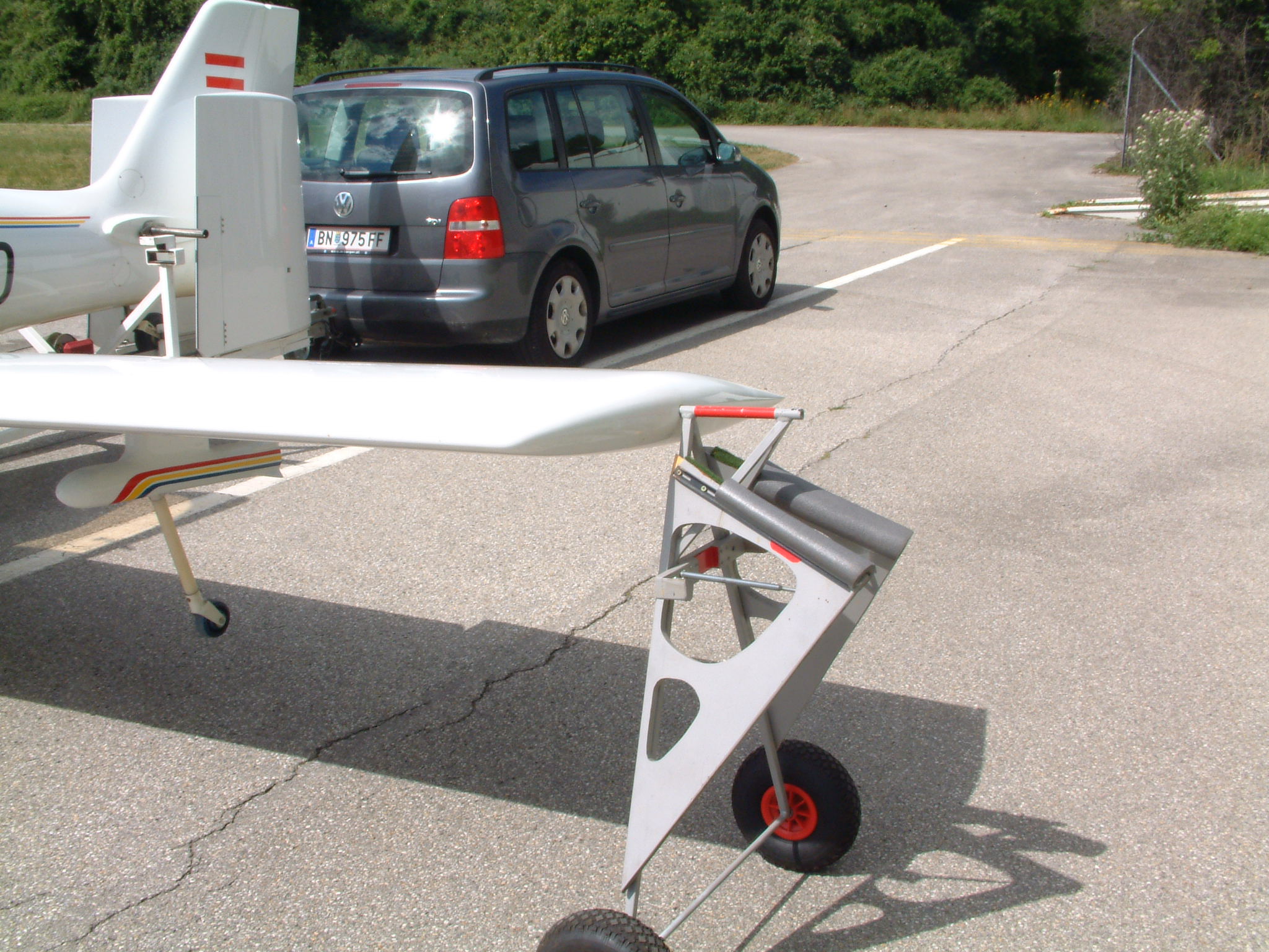

grahamsingleton(at)btinte
PostPosted: Mon Jan 12, 2015 2:20 am    Post subject: Removing and Attaching Wings Single Handed Reply with quote
Alan
have a look at Andreas Doblhof's one man rig. Five minutes when I watched him do it
Graham

On Monday, January 12, 2015, GRAHAM SINGLETON <grahamsingleton(at)btinternet.com (grahamsingleton(at)btinternet.com)> wrote:
[quote]Alan
Graham

This is what I found about Andreas Doblhof's system:
http://www.europaowners.org/main.php?g2_itemId=46082
http://sdunsmuir.net/EuropaOwners/public_html/Galley3/Builders-Album/Dolly/Andreas-Doblhof-s-rigging-system/Andreas_Doblhof_home
The Europa sports the Austrian flag on its fin and the vehicle has
similarly an Austrian number plate.
George Nielsen
