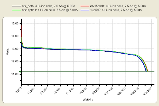

I'm presently in possession of one of these
products:
http://tinyurl.com/jwk9wcu
Note that the ad says this is a 'drop in' replacement
for the Yuasa YTX20 series batteries (18 ah at a
10 hour rate), the YTX24 series (21 a.h.) and the
UB12350 (35 a.h.). This statement should raise some
eyebrows. The ETX36 may indeed CRANK like all of these
batteries it purports to replace.
Here's part of the data I've collected off this sample
thus far:
[img]cid:.0[/img]
When loaded to 5Amps, this battery consistently delivers about
140 watt-hours of stored energy for a 2-hour rate of 11.5
ampere-hours. We also see that this battery's charge cycle
is pretty well ended at 12 volts, one full volt higher than
end of charge on an SLVA battery.
Incidentally, the family of curves cited above shows that
out of the box, charged at 13.0 volts, 14.0 volts, and 15.0
volts, the device dumps a consistent energy value. This speaks
well of the battery's internal battery management system.
So how would this battery stack up for battery-only operations
when replacing any one of the devices for which it is sold as
a drop-in replacement?
These data suggest that if your application calls for a KNOWN
level of stored energy the ETX is NOT a drop in replacement
for the products listed . Assuming that this battery, or one of
its cousins, meets your cranking and stored energy requirements,
then how does it stack up for a weight reduction goal at $350
a pop?

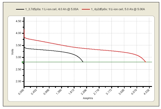

We have a similar situation here. The
energetic hawkers of lithium are quick
to point out engine cranking abilities
in terms of 'equivalencies' but without
hard numbers for EVERY feature of lithium's
performance. So just as we saw with Bolder
products, successful incorporation of
the new technology requires that the
system integrator (that's YOU) understands
the trade offs not only in weight and load
dump but capacity, low temperature performance,
and requirements for exploiting capacity (system
voltage). My early studies have demonstrated
that a 4-cell stack of lithium gets De-rated
in a 14.4v system to approximately 1/2 of
potential capacity.

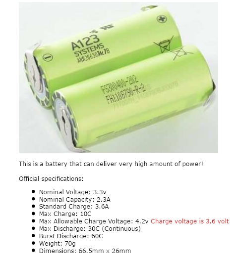

This means that for cell-paks consisting of
arrays of 26650 cells, the USEFUL capacity
is less than the POTENTIAL capacity. Revisiting
the data published by A123 on their 26650
cell offering we see:
[img]cid:7.1.0.9.0.20141104091241.01fa1008(at)aeroelectric.com.0[/img]
Note that while they speak to a MAX ALLOWABLE charge
voltage of 4.2 (pretty much standard across the spectrum
of lithium cells) they also speak to STANDARD CHARGE
and NOMINAL CAPACITY? with numbers on the same order
as demonstrated by my experiments thus far. A123 data
speaks directly to this 14v system de-rating phenomenon.
One point that has not been made in their favor is that substitution of a 3 to 4# battery for a 20 to 30# one may solve a weight and balance problem without needing to move the battery to the tail cone and adding long and heavy cables.

Not 'unused' . . . but not even pumped into the cell during charge for later recovery during discharge . . .
[img]cid:.0[/img][/b]
In the plot above we see the recovered energy plots for the same cell topped off at 3.7 volts and 4.2 volts. When charged at the higher voltage, the cell presents as a 3.7 volt source. When discharged at 5A, the cell tossed in the towel at about 4.4 a.h.
When charged at 3.7 volts, it presents as a 3.4 volt source and tosses in the towel at 2.1 a.h.
Maybe that is true for LiFePO4 compared to other lithium products but not, I believe, for LiFePO4 as such. Maybe that is what you mean?
I have found no literature that speaks to major differences between the lithium couples . . . but in any case, LiFePO4 is the technology of choice.
I believe that the following may be true for a LiFePO4 (A123) cell:
1. there is very little capacity between 3.6V and 4.2V (using a 0.1 or 0.05 C cutoff)
I excerpted an image earlier from A123's specifications for their LiFePO4, 26650 cell where they made it clear that while 4.2 is the max allowable charge voltage, 3.7 was the nominally adopted charge voltage.
2. the 4.2V maximum is intended for specific fast charging methods with a short stay at 4.2V followed by a much lower float voltage
3. 4.2V is not immediately damaging but not good for long life
I've read nothing to date that speaks specifically to such a notion. But anecdotally, the 'big guys' are reported to favor the cycling of lithium in their products between the bounds of 20 and 80 percent of potential charge. Of course, the 'big guys' can PICK their system voltage for the purposes of meeting design goals.
We're pretty much stuck with that belt-driven thingy up front set for 14.4 volts, when divided by 4 yields 3.6 volts. Okay, lets jack up the regulator to 14.8, no big deal.
The point is that properties of materials (LiFePO4) married to our energy management constraints (14.8 volts) says that ANY lithium product we may choose to install will be operated between approx 50% and some lower level close to 0% 0 - assuming that the BMS or pilot watching the battery-only voltage shuts things down at 2.8 x 4 or 11.2 volts.
This idea is re-enforced by the testing I did earlier on an AeroVoltz product which had all the outward appearances of being a 3x4 array of 26650 cells. I suggested before testing that the thing was probably going to test out in the neighborhood of a 7.5 a.h. battery . . . which was confirmed as I recall. I need to dig that data up . ..
You could test and quantify point 1 above if you like?
I think the data gathered and presented above supports my perceptions and subsequent assertions . . . This also lends some understanding for the wide variations in advertised capacity of the various Li products. One supplier may be speaking in practical terms for long life of their product while others may be capitalizing on the chemistry's potential capacity. When used in something with modern power conditioning electronics (constant current to LED in flashlight, switchmode power supply in a computer, etc.) one can indeed stuff more electrons in for future recovery at the higher design point of 4.2 volts. But our 14 volt airplanes and other vehicles are what they are . . . so dropping lithium into the battery box says we're bounded by the 0-50% box which, by the way, promises much longer service life.
