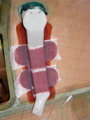

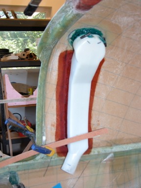

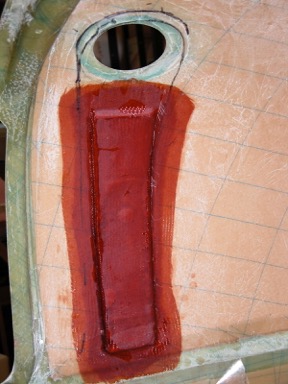

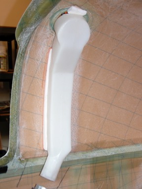

Willy…in accordance w/ solutions offered on the list, I’ve separated my fuel filler from the fuselage skin w/ a sheet of foam per the attached pixs…no direct flight experience…Fred

ptag.dev(at)talktalk.net
PostPosted: Sat Dec 27, 2014 2:37 pm    Post subject: Warping or shrinkage of fuselage around and below fuel fille Reply with quote
Hi! Will,
The condition you relate is quite common when bid straps are used to attach
the filler "telephone" type of fuel filler moulding. But it only reflects
the curing of the actual straps where it adheres to the inner skin. I think
the later suggestion was to apply a large area of bid prior to using the bid
straps on top of that. Hopefully yours isn't worse than that?
Bob Harrison G-PTAG.

PostPosted: Sun Dec 28, 2014 8:37 am    Post subject: Warping or shrinkage of fuselage around and below fuel fille Reply with quote
Willy
Short answer:
The dent is caused by fiberglassing the plastic neck to the skin directly.
As the fuel vents vapor, the neck cools and shrinks, deforming the outer
skin. Techniques to allow the skin and neck to move independently are time
consuming and must be made to keep the neck secure in all directions yet
movable... To prevent damage during refueling one has to consider making
the neck firmly attached to the fuselage, in the event a line boy sticks the
filler in the fuel neck and hang on it. Failure here would be a disaster.
It is necessary to secure the neck hard to a reinforced fuselage side.
Techniques:
We prefer to heavily reinforce the fuel neck skin attach area as a safety
precaution.
On a new build, simply put a 1/4 inch piece of blue foam just larger than
the cobra neck width by at least 1/2 inch. Bevel the edges at a 45. It
should be from 1/2 to one inch shorter than the curved flat cobra section.
On a used aircraft, cut the straps off carefully (you will find that epoxy
sticks to the PTFE plastic very well). We often cut the FS18 neck
completely off. Then heat the metal ring and remove. Consider installing
the new style cap at this time. The outside dent will be a problem. All I
can say is de-paint, fill, glass over, fill again, and repaint.
We at Custom Flight Creations simply fit our neck and filler and mark the
skin. Remove and add the foam and put two layers of glass over it. Use
micro and flox as appropriate. Many have asked how we curve the foam to the
skin. In the past we used large clamps that reach in, however, you can also
score the foam, use micro to stick the foam and simply use long sticks to
hold it in place. To be honest we now use blue foam safe super glue to
tack the foam at the top and bottom and hold it secure until the micro
cures. Obviously, one must leave the foam free of micro in the superglue
tack areas. Once it is stuck we then smear micro and flox over the foam and
put two layers of glass over the foam and peel ply down the sides and across
the bottom. Done in a day.
Reinstall the cobra neck and cap in place over the reinforced skin (Redux
the cap area). Apply glass straps as per the manual over the plastic and
lap only to the foam reinforcement area. No problems encountered in 16
aircraft.
