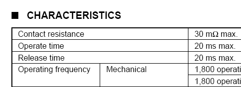

A relay in the same 'class' as you describe
[img]cid:7.1.0.9.0.20141215165823.01fc4710(at)aeroelectric.com.0[/img] [img]cid:7.1.0.9.0.20141215165823.01fc4710(at)aeroelectric.com.1[/img]
. . . has a published maximum resistance of 0.030 ohms
[img]cid:7.1.0.9.0.20141215165823.01fc4710(at)aeroelectric.com.2[/img]
according to specs . . . a drop of 20A x 0.030 ohms = 600 millivolts
or about 1.2 watts of dissipation at the contacts. I can
guarantee that contacts of that mass dumping that much
heat would not be long for this earth.
As a practical matter, any time you measure more than
100 millivolts across any set of switch or small relay
contacts at these kinds of loads, it's worth your time
to see if the critter is getting into trouble.

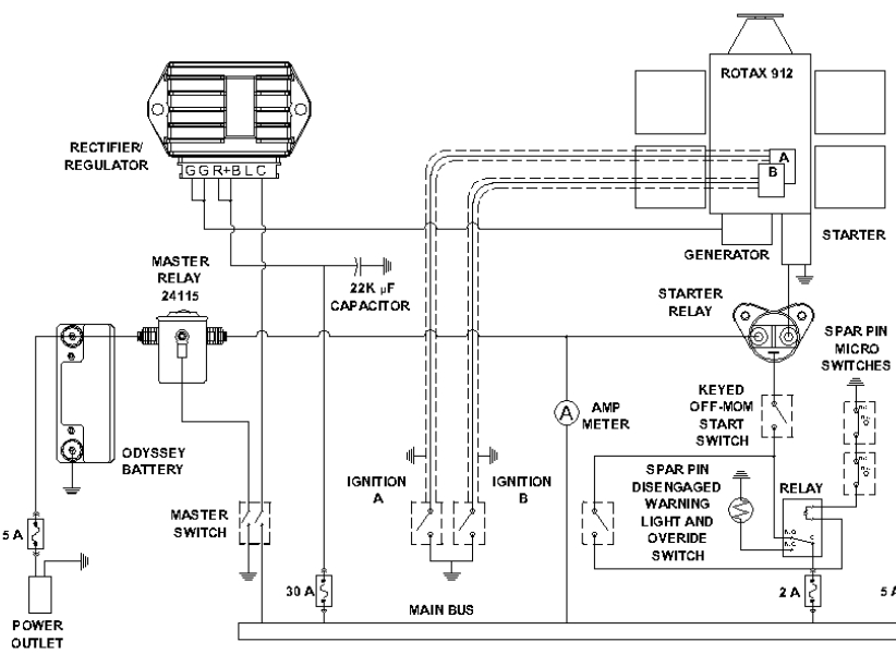

I'm surprised they did that. Here's an excerpt from
another Rotax document that seems to avoid that
pitfall nicely . . .
[img]cid:7.1.0.9.0.20141215190447.01fd1770(at)aeroelectric.com.3[/img]

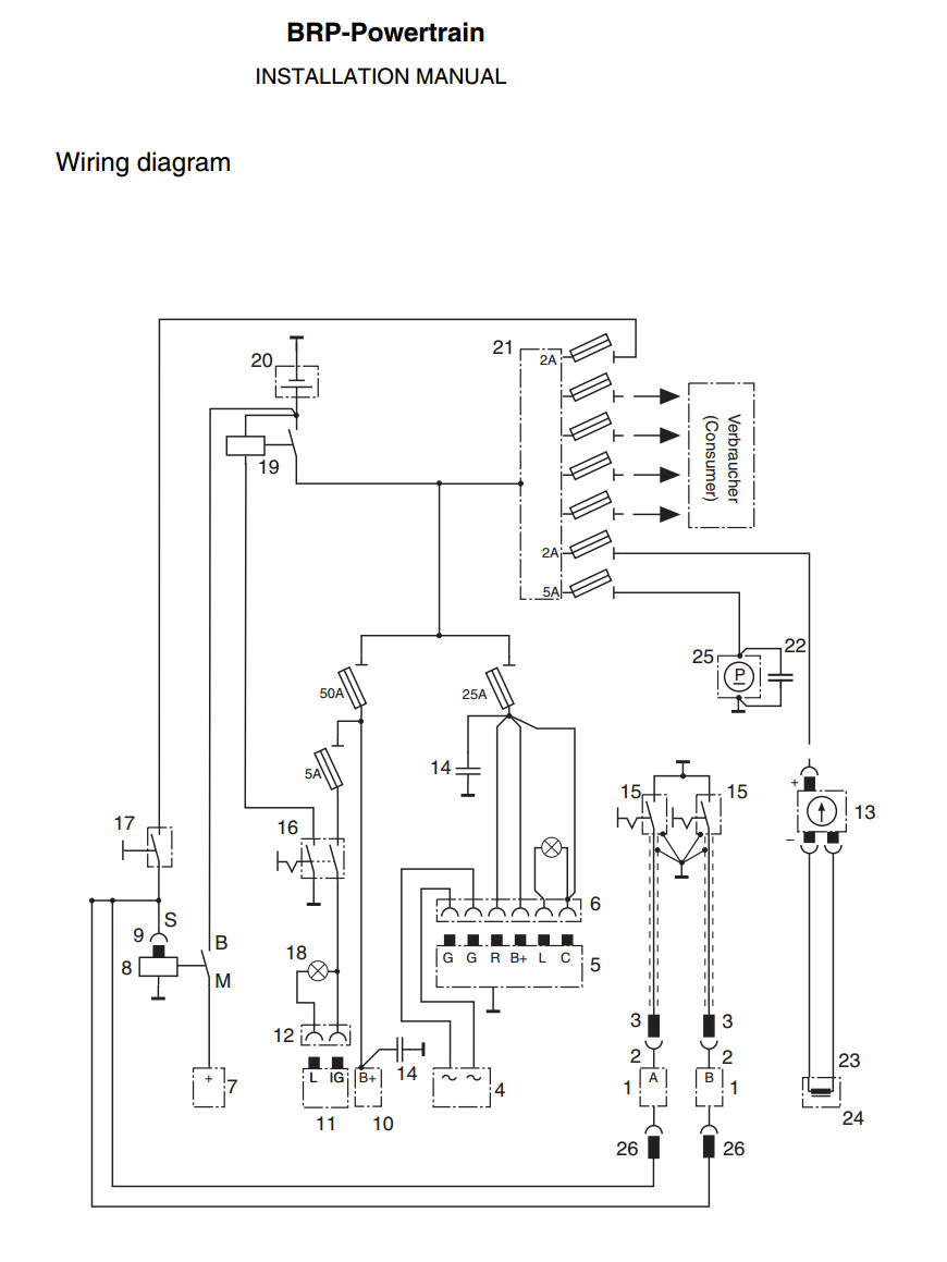

The Rotax Installation Manual http://www.flyrotax.com/portaldata/5/dokus/d04967.pdf
shows a battery contactor between the battery and main bus and a 25 amp circuit breaker between the main bus and the regulator. There are no small relays used in the regulator circuit. During normal flight, only battery charging current flows through the battery contactor. Any voltage drop across the battery contactor does not affect the output of the voltage regulator. The Rotax wiring diagram has a couple of issues: the master switch does NOT shut off the dynamo, and the starter contactor is connected directly to the battery instead of being in series with the master contactor like many E-AB aircraft are wired.
The schematic that Bob posted is not from Rotax but is actually from Van's Aircraft RV-12. I recommend NOT using the Rotax schematic. Instead, wire the rectifier/regulator per Van's schematic with the addition of a 5 amp fuse in the terminal "C" circuit at the main bus. The regulator "C" sense circuit and "R+B" output circuit should be wired with separate paths to the main bus. Then the voltage drop to the "C" terminal will be minimized because only milliamps will flow in its circuit. Less current results in less voltage drop. Bob, please correct me if anything that I said is wrong.
See attached picture of the Rotax wiring diagram.
Below is the key to reference numbers on the Rotax wiring diagram:
1. Electronic modules (A and B)
2-3. plug connection for ignition switch
4. Integrated generator
5-6. External regulator - rectifier with plug connections
7. Electric starter
8-9. Starter relay with plug connection
10-12. External alternator with connections
13. Electric rev-counter
14. Capacitor 22,000 microfarad
15. Ignition switches
16. Master switch
17. Starter switch
18. Control lamp
19. Battery relay (contactor)
20. Battery
21. Bus bar
22. Capacitor
23. Plug connection for trigger coil assy.
24. Trigger coil assy. (tachometer)
25. Electrical fuel pump
26. Starting equipment at the electronic modules

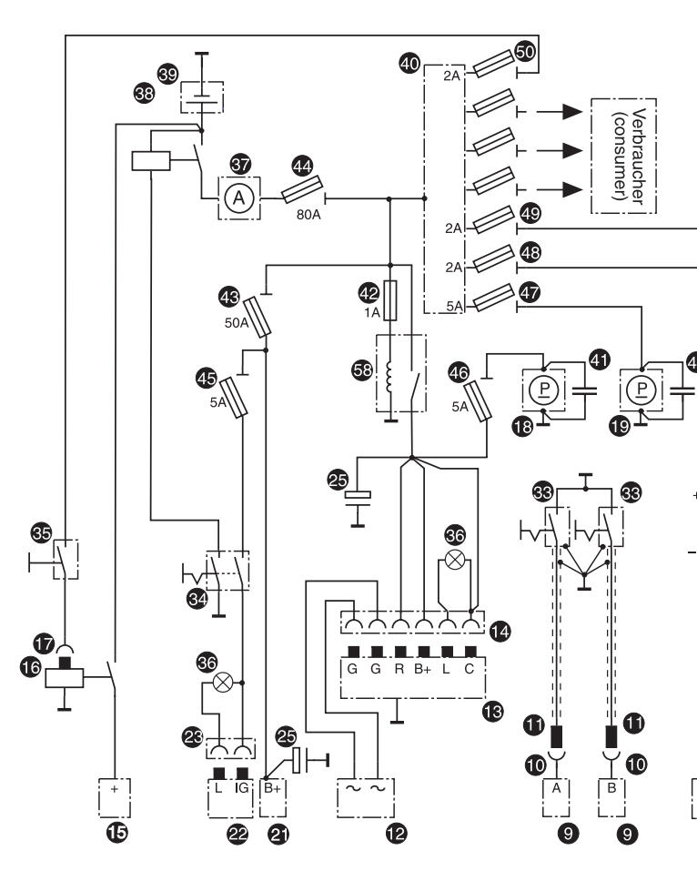

Joe, The Rotax diagram I'm looking at is for the 914 and it has the C wire going through one relay plus the battery contactor.
Ken,
You are right. I was looking at the Rotax 912 schematic, not the 914 which has fuel injection. I can understand why the regulator "C" terminal is connected directly to the "R+B" terminals. They want the dynamo to supply power to the fuel pump with no way for the pilot to shut off the regulator. Therefore, I take back what I wrote about connecting terminal "C" according to the RV-12 schematic (unless all scenarios have been considered). If you wire the regulator according to Rotax's schematic and are concerned about the voltage drop across the regulator relay, then consider a double pole relay with the the poles connected in parallel. http://tinyurl.com/DPST-Relay
