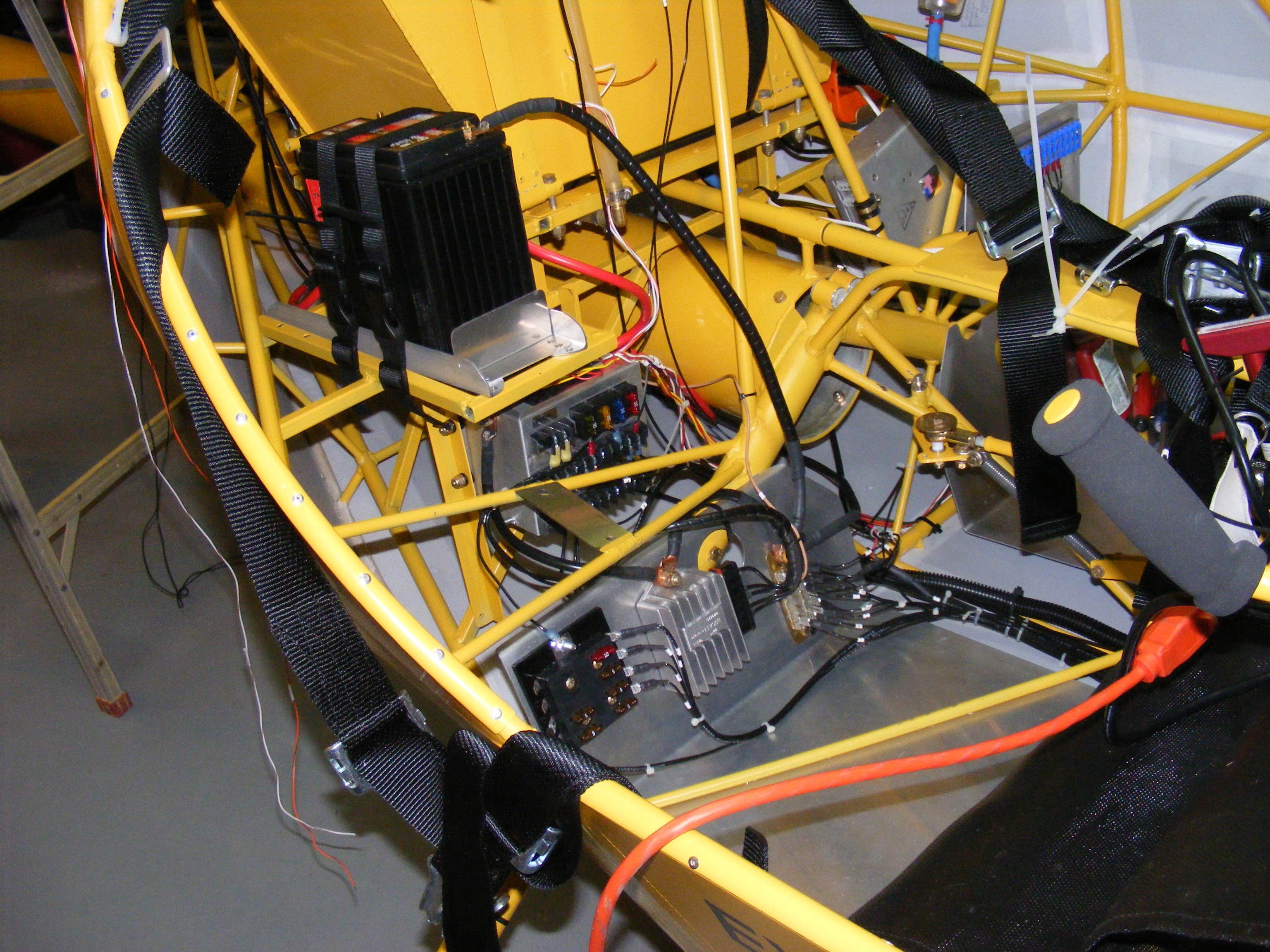

I'm sure grounding to the frame will work fine. Many people do it. I just felt more comfortable with a separate grounding plate for all components.
See attached picture. It's the brass/copper colored plate mounted to the aluminum seat pan.
