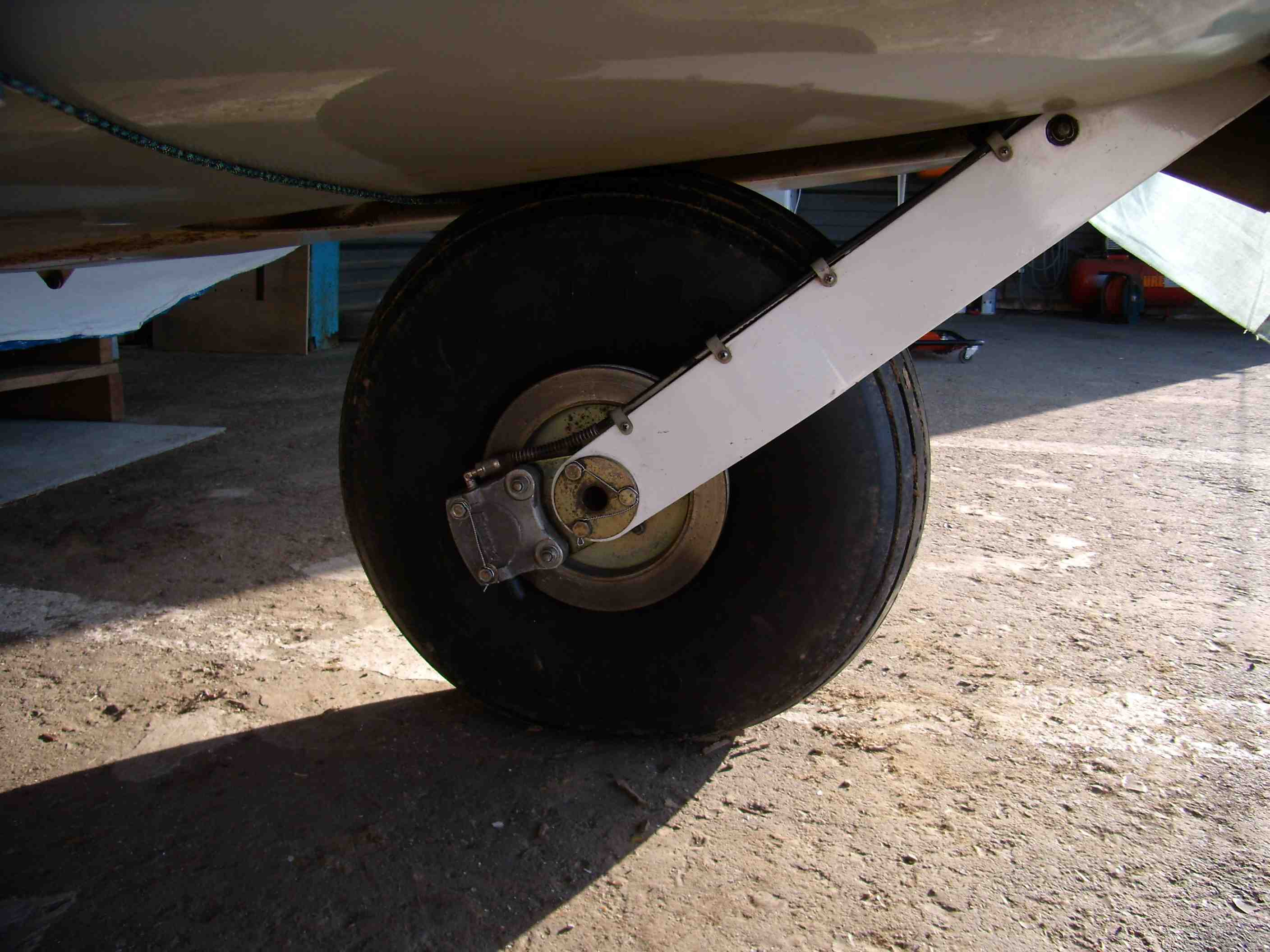

Remi Guerner
Joined: 14 Dec 2010
Posts: 284
PostPosted: Fri Dec 05, 2014 12:38 am    Post subject: Re: monowheel brake caliper mounting position Reply with quote
Fred,
I changed the position of my caliper a few years ago. The attached picture shows how it is now. This position was choosen so that, when in the landing gear is in the retracted position, the caliper does not interfere with the starboard rudder cable as it did before and it does not protude in the slipsream.
Remi

Fred Klein
Joined: 26 Mar 2012
Posts: 503
PostPosted: Fri Dec 05, 2014 6:29 am    Post subject: monowheel brake caliper mounting position Reply with quote
Thanks Remi…picture’s worth 1000 words…Fred

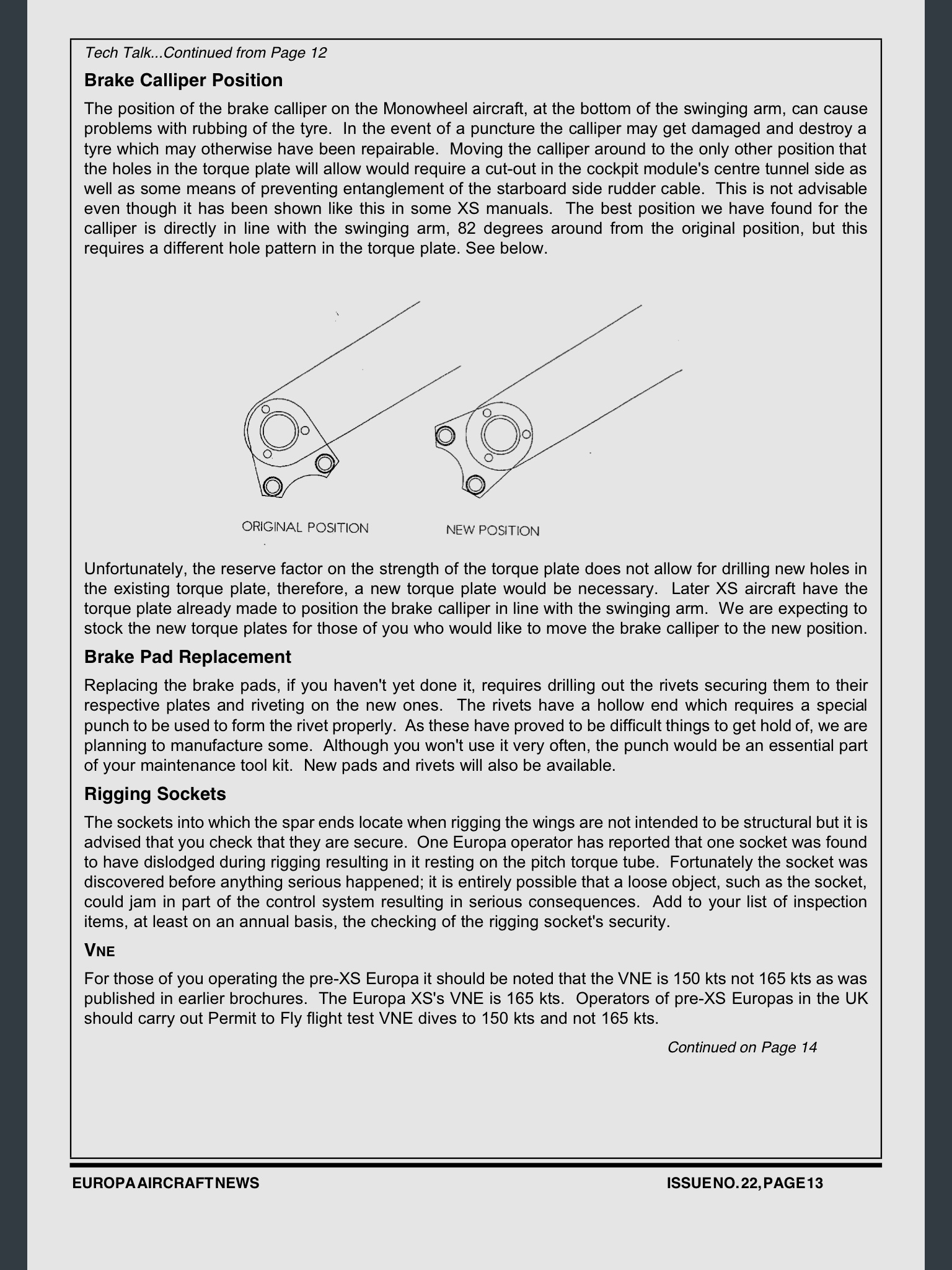

JonSmith
Joined: 21 May 2010
Posts: 110
PostPosted: Fri Dec 05, 2014 10:42 pm    Post subject: Re: monowheel brake caliper mounting position Reply with quote
Hi Roland, the (revised) brake caliper position was covered in the factory tech talk issue 22 on page 13. Attached is a copy of the page. I bought a new mounting bracket from the factory some years ago to replace the original design on my classic. Five minute job (almost) to replace it and it saves carving holes in the wheel well sides! Cheers!

rowlandcarson(at)gmail.co
PostPosted: Sat Dec 06, 2014 12:25 am    Post subject: monowheel brake caliper mounting position Reply with quote
Jon - thanks for the info. I hadn’t realised this discussion was soooo long ago! I do have a SX kit and so my brake caliper is already in the recommended position. I can relax now (about this issue, anyway).
