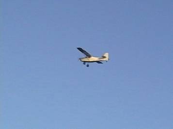

Attached is a picture from the brief video.
