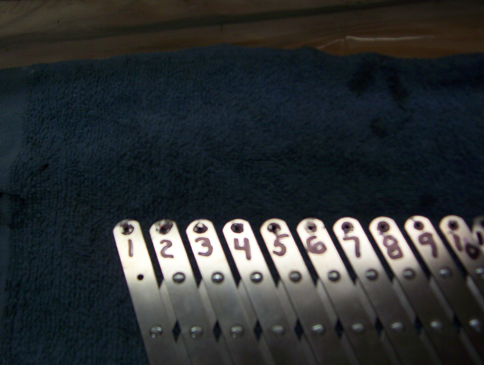

I'm perplexed. Looking at the plans (6T3) we're told to put 9 rivets in the top skin at 40 pitch on the outboard ribs. Then we're to go to 10 rivets at 40 pitch on the other four ribs.
Two problems:
1) On the outboard ribs, this puts the last rivet beyond my elevator rib tip. Do I reduce the pitch or forget the last rivet?
2) On the other ribs, 10 rivets at 40 pitch extends out to 360mm on a skin that is only 345mm wide. Either I need to adjust my pitch to something less than 40mm, or stop at 8 to catch material on my ribs.

I ran in to the same problem and solved it by knowing 40 pitch is the maximum pitch, you can always go for less pitch. Some of my 40 pitch are actually 35mm.
What I did is marked the end rivets at the correct edge distance then set the fan to fill the void with the correct number of rivets. If it came out at 35mm, so be it.
Here is a picture of my rivet fan. I wrote numbers on it so I don't have to count, hows that for lazy8)

Ron,
That sounds like a workable solution. Unless I hear from anyone else on the list who has a convincing argument to the contrary, that will be my plan.

Ron’s explanation is exactly right.
