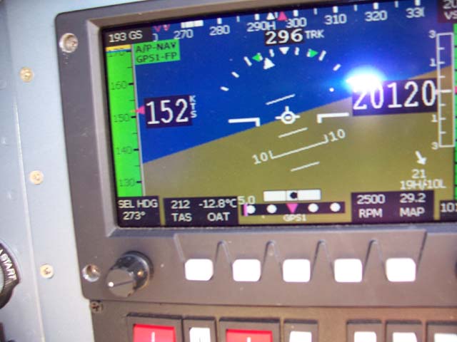

Assumptions:
Vne is based on IAS, and for the -10 is 200kts (at) 5000'.
Vne is adjusted by 1.5% for each 1000ft of alt.
At 20000ft, Vne is therefore 15(000)*1.5% less than 200kts (ie 155kts Indicated)
Check out the attached photo from a turbocharged -10 operating here in Oz. Yes that is 152 kts at 20120' (Note the TAS in the bottom left corner and yes, they are knots!)
If published Vne is 200kts at sea level, Vne (at) 20000' is close to 140kts (70% of 200kts)
If published Vne is 200kts at 8000', Vne (at) 20000' is close to 164kts (82% of 200kts)
Fast - yes, but a bit too close to the edge for this little black duck! I would be interested if anyone knows what the designed Vne (and associated altitude) actually is.
