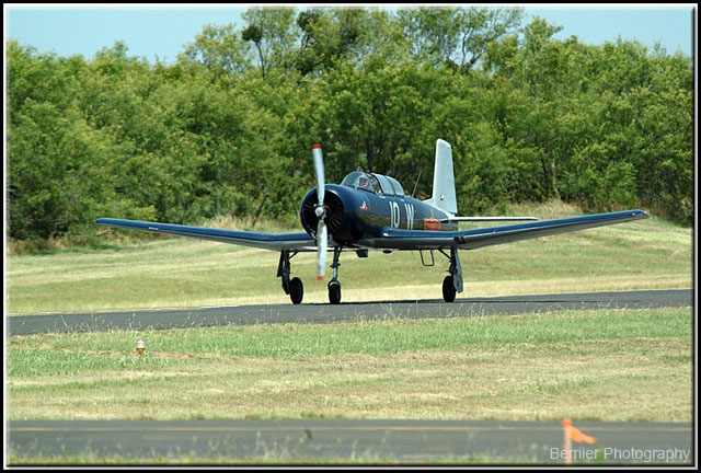

I've attached a photo of my plane. I've altered many areas. Taylor wire, spark plugs, alternator, aux. fuel plug, pre-oiler, K&N air filters, on board charging system, 24 and 12 volt buss, and dropped the weight by 254 lbs.
Jim B
