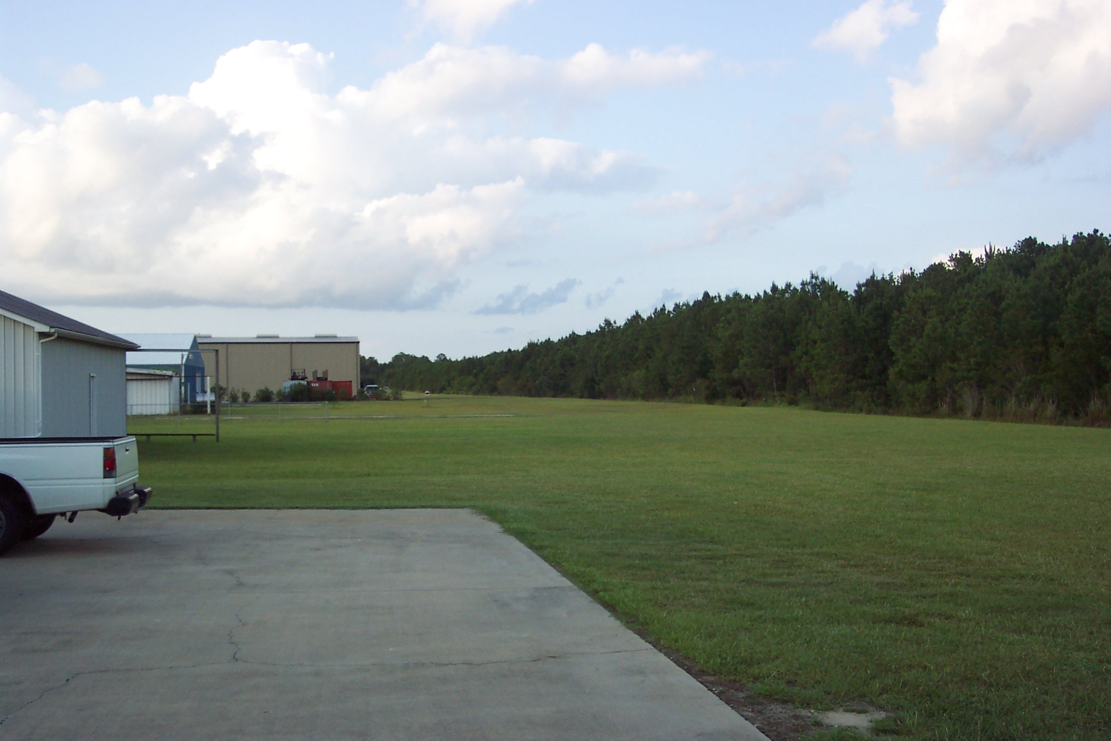

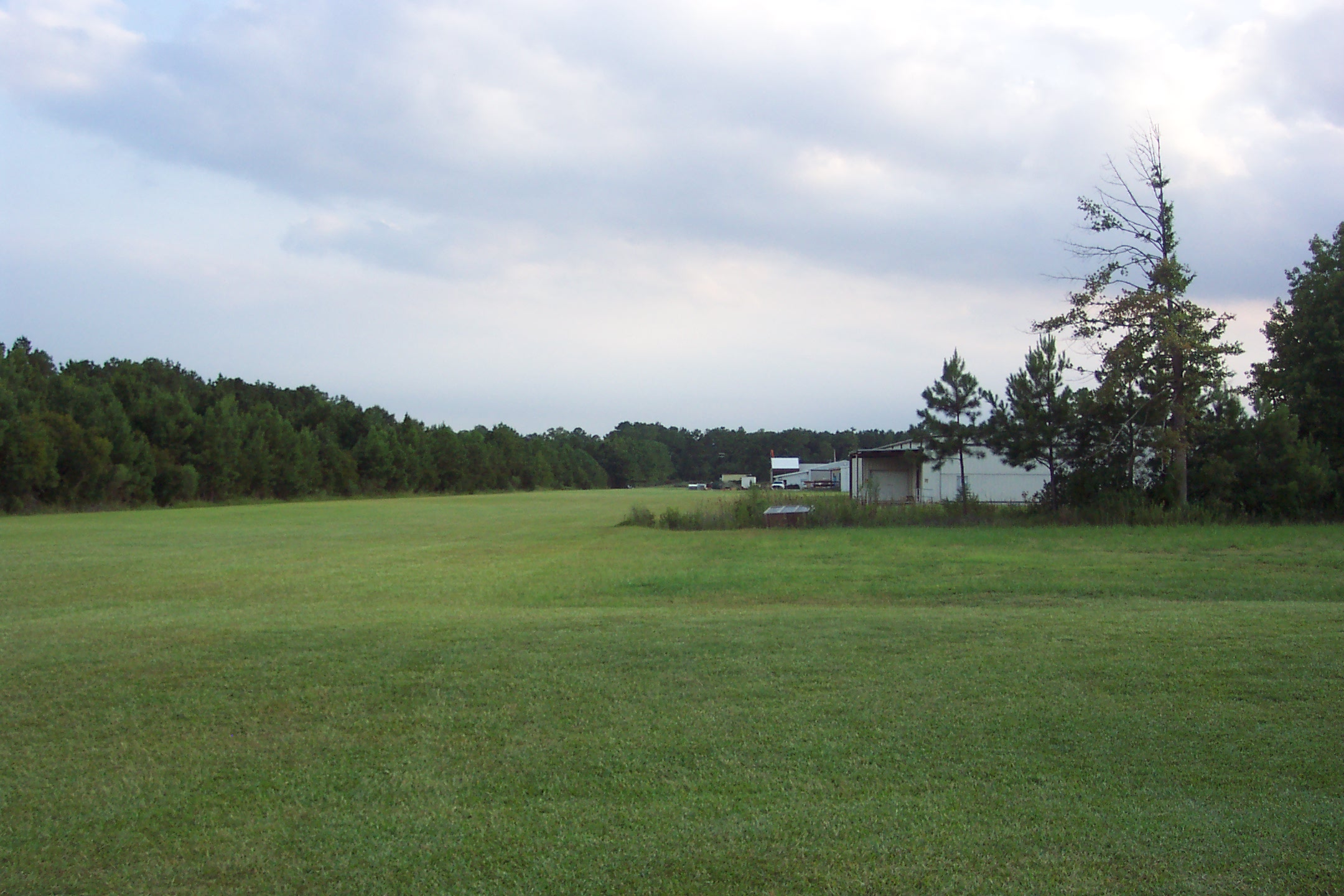

PostPosted: Fri Oct 13, 2006 11:19 am    Post subject: Re: crosswind Reply with quote
Right now, until I get some more practice, I'm limiting myself to a 10 MPH (8 KT) crosswind.
I went out and did some landings yesterday in this condition and they were a fun ride! Of course I've got lots of Mechanical turbulance that is effect at my field (houses, buildings, hangars, trees) really close to the RW (sometimes right up to the runway). (see pictures below)
I'f I'm at a real airport with more of an open space with little interference, maybe I'll bump it up to 10 Kts
I've got no problem in a GA plane in handling all the way up to (and sometimes above) the Max demo Xwind for the planes, but our birds are so light, they don't have the momentum going for them to keep them straight.
