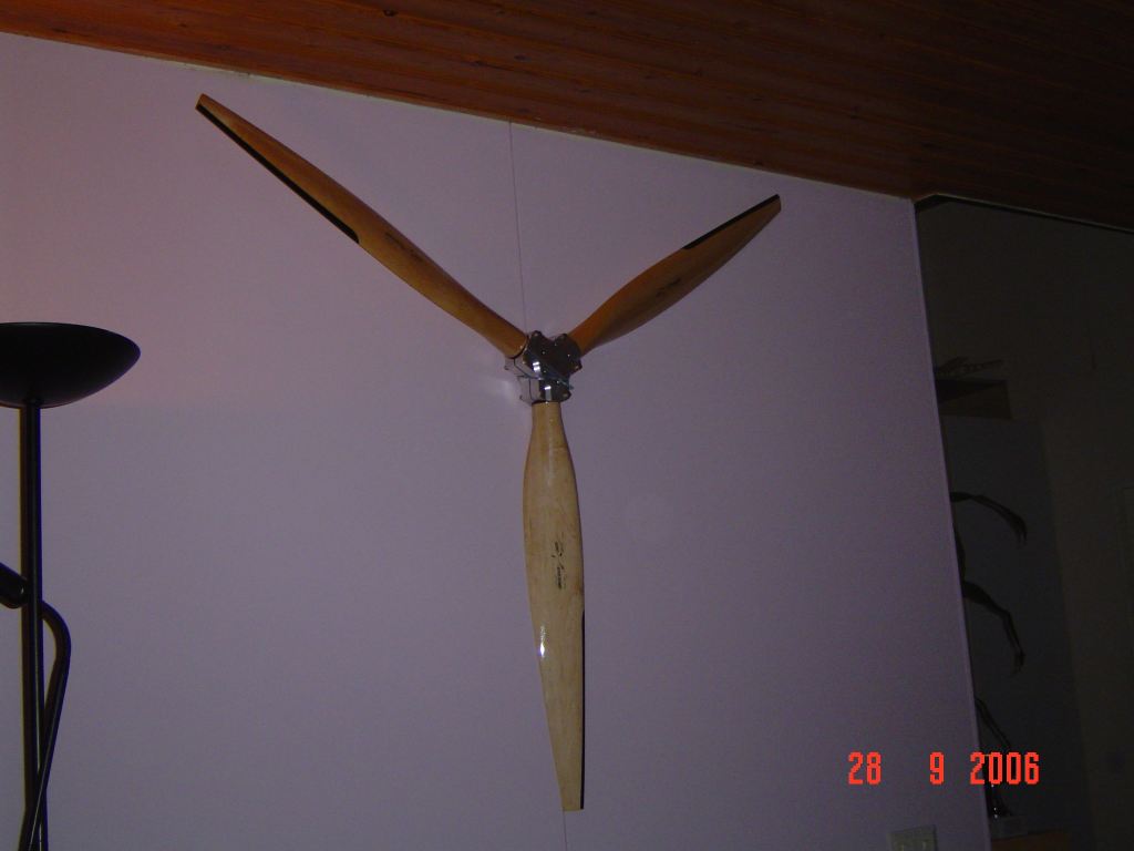

Especially for builders, who has GSC's 3-blade wood propeller on your CH701
with R912 or R912S.
Could you get answer for few question:
- Diameter of your propeller 68", 72"....
- Engine type (912, 912S, 914 other...)
- Blade angle (if flying or tested or....)
- Cruising speed (if flying...)
(See attached file: rupelli.jpg)

PostPosted: Tue Oct 10, 2006 7:51 am    Post subject: GSC propeller and CH701 Reply with quote
Hmmmm... have to say, I like this prop, but it seems to be better
leave it for decoration purposes after 15hrs taxiing tests.
