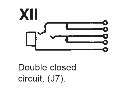

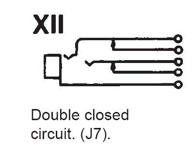

Wondering if you have what's called a "closed circuit" jack
intended to disconnect a "primary" load (like built
in speaker) when the "secondary" load (like headphones)
is plugged in.
A schematic for such a jack is attached. It has a total of
5 connections right and left inputs, right and left outputs,
plus ground.
Does this look like it matches your jack? What's the Radio Shack catalog
number for the part you have?
