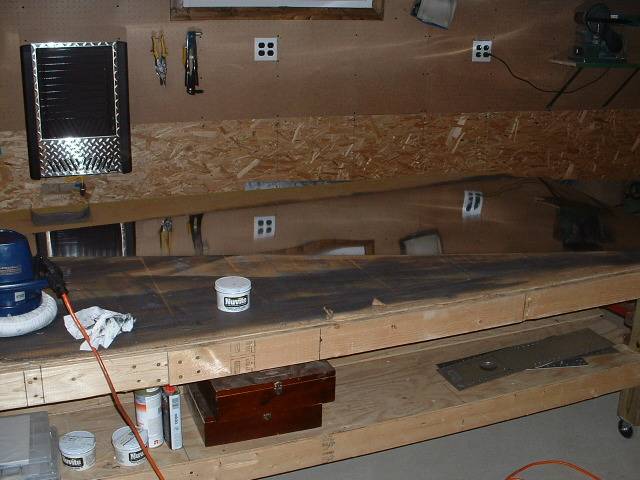

All-
Spent the day getting this PIA to the point you see. Remember, this was the EASY skin. About 4 hrs.
Bill Naumuk
HDS Fuselage
Townville, Pa

cscsail(at)gmavt.net Guest
Posted: Sun Oct 01, 2006 3:28 am Post subject: PIA depicted |
Bill,
Looks great, but I noticed you are using what appears to be a light duty polisher for car waxing. I use a Porter Cable 6" Random Orbit Polisher with a speed control and a foam compounding head for the initial work and then use a cloth pad for final polishing. There are other tools that will do a great job as well, but I didn't have the patience to use a car polisher that looked similar to yours.
Gordon

naumuk(at)alltel.net Guest
Posted: Sun Oct 01, 2006 7:59 am Post subject: PIA depicted |
Gordon and all-
My first response got zapped out by Norton- seems someone wants to change my home page. Big deal- they can have it.
I have two auto polishers, a 6" and a 9". I thought the 6" was a straight up rotary, but it turns out it's an orbital, too. Regardless of the brand, I would recommend a straight up rotary for the first pass. Good luck finding one. The bonnets on those that chuck in a drill don't hold tight enough. The bonnet stays still while the backing plate grinds itself to pieces. At this point I have more money in bonnets than the polishers.
Tim Shank turned me on to the Nuvite system, and I have no regrets other than the fact that ACS doesn't carry the heavier F grits. I decided to scrap the fuse side skins and cut new ones using the plastic coated sheet available from Wick's. I'm not comfortable with the fact that I had to remove the worst of the corrosion with 220 grit- I'm sure I weakened the sheet. I figure that I can polish the remaining structure with no coarser than G6. Between not having to pay $40 for an F grit (If I could find it) and the time savings of polishing virgin aluminum, I'm time and money ahead cutting new skins. What the hell, I've got a 50% scratch-built kit as it is!
For those into "Alternative methods" I repeat my observations. Mother's is the grit equivalent of G6, and Dupont Polishing Compound is the equivalent of C. Nuvite S may well be in a category of it's own. I can't say what the corrosion protective qualities of the alternatives are and don't really care since I'm only using the alternatives far upstream of Nuvite C and S.
Good building!
Bill Naumuk
HDS Fuselage
Townville, Pa

tshank(at)core.com Guest
Posted: Sun Oct 08, 2006 6:02 pm Post subject: PIA depicted |
Bill,
Just saw this message, it was caught in my spam filter, anyway you mentioned that AS only carries part of Nuvite's line. I buy mine directly from Nuvite either on-line over the phone or this year up at Osh. You might check with them if the F grades are still available. According to their website http://www.nuvitechemical.com they have F9 and F7 available.
Tim Shankland
