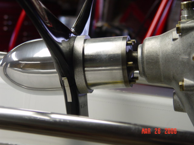

See picture of existing prop mount. Stack-up from ‘B” box prop mount to prop centerline is 2.0”.

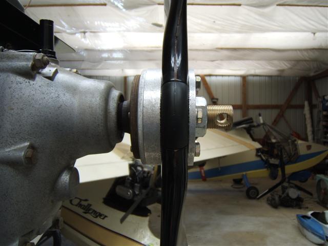

Here's a picture of my prop extention...
Gotta Fly...

Hey, Planecrazzy, Sorry. But what I said was " "you have the 5 inch spacer?" There was a Question mark refering to you (first person) asking me if I had the 5" spacer.
That covered, That is the largest 3" I have ever seen. Must be the angle.
