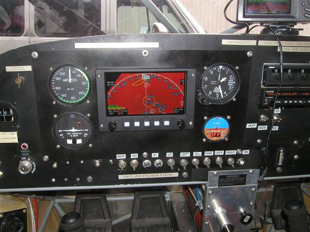

Just installed a GRT Sport in the Glastar. picture included. The 10 is a dual battery, dual buss, single alternator. Instrumentation is dual Cheltons (gadahrs), Digiflite autopilot (internal gyros) and TT 2,25" ADI (if they build it). Three ways to fly the aircraft in IMC.
