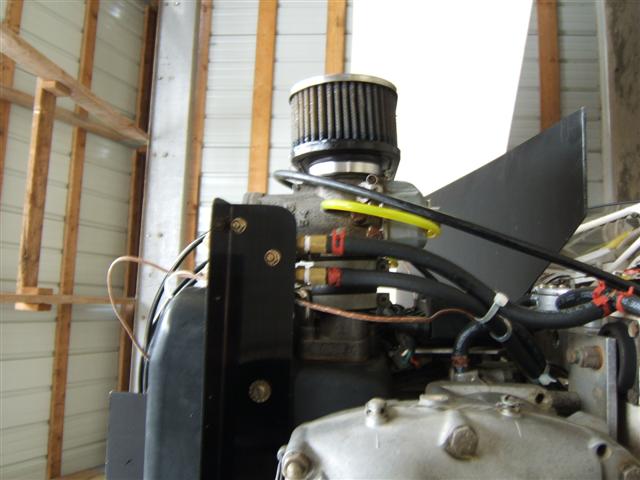

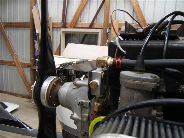

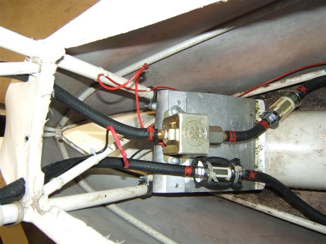

I have enclosed the pictures of the duel fuel supply system I and several others are using at our field. If you need more details, let me know. No fuel related problems on any of the planes to date.
It contains:
1 aluminum mounting plate whcih mounts using existing engine screws.
2 bottom outlets on the new Kolb 6 gal. fuel tank.
2 Fuel filters with glass visual.
1 Facet fuel pump.
2 Check valves.
1 Manifold with pressure gauge inlet (no gauge installed as yet).
An easy access panel to see and correct any fuel related problems in the rear of my KXP Firestar with 503 DCDI.
The idea here was to have a back-up fuel system in case the mechanical pump mounted on the engine quite. Incorporating this idea was the need to NOT create another potential problem, leak path, or in flight worry. Using this approach, the fuel cannot "loop" back through the system if one half of the duel gave out or leaked. The other is to make sure that there was a way to "check" both halfs of the duel fuel supply system. Electric fuel switch on, pump (electric) pumps. Feel bowls full, start engine. Turn off electric fuel pump, now system is reliant on machanical fuel pump. Run through check list, enter field. Throtle up full, check mags. Throtle down, turn on electric fuel pump and "Bob's your Uncle"!
Oh, In order to use this approach as I have it noted above, you need at least a 5 amp battery for the system. I do not use an electric start, but do use back-up electric with my glass instruments. No info is not a nice place to be in an airplane. The battery cost $ 24.00 and weighs very little. It is mounted directly under my seat on the right side.
Any suggestions, recomemdations or questions?

Another view of the manifold and associated hoses and mount.
 Filesize:  55.94 KB
 Viewed:  294 Time(s)

Looking at the mount and the manifold on the 503.
 Filesize:  49.96 KB
 Viewed:  304 Time(s)

Looking into the area behind the fuel tank.
 Filesize:  56.46 KB
 Viewed:  306 Time(s)
