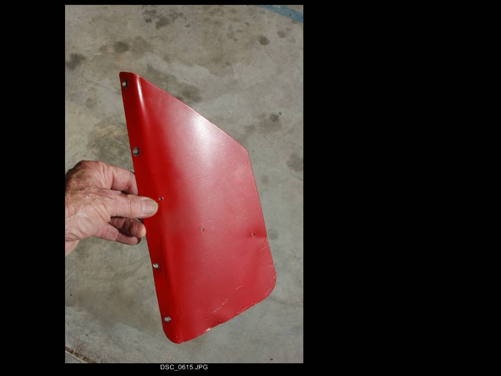

Have been holding right rudder...just a bit... to keep it straight at 50 mphi and about...not sure, but about ... 5300 rpms. Decided to try "feet off" and got slight nose pitch up and what felt like a slight flutter somewhere behind me. Can't see what's going on back there. Not reassuring, though. Back to pedals and okay again, but holding a bit to keep it straight and flutter disappeared. Did it twice. Air calm, conditions ideal.
The huge rudder trim tab (12" tall and 6 3/4" wide at bottom, bent about 15 or so degrees to right as you face the cockpit, and riveted 22" down from top on the trailing edge pipe of the rudder), was sloppy, loose. Drilled the aluminums and the one steel rivet wasn't attached anyway, intending to find a better way to attach the tab to the round pipe surface.
A&P said it you are having to hold right rudder, you are already fighting that trim tab.. "Try flying it without it." Think I read one of the Kolber gurus said you gottas have em, nature of the beast and all that.

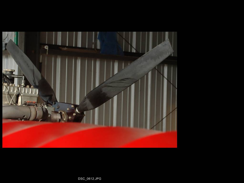

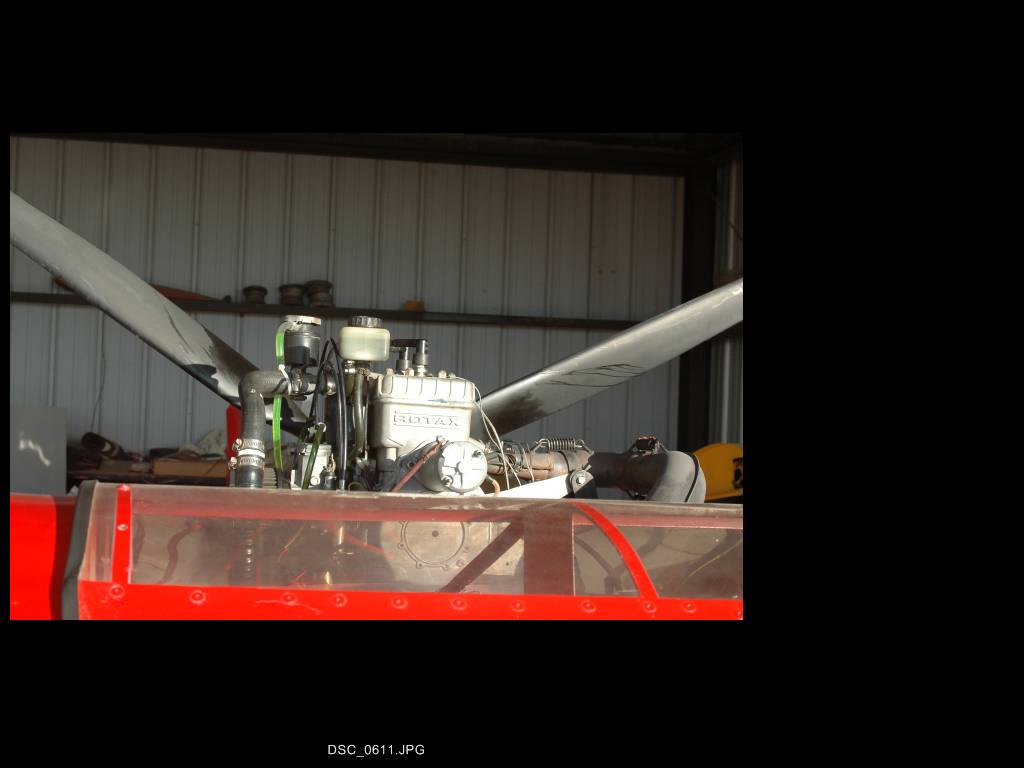

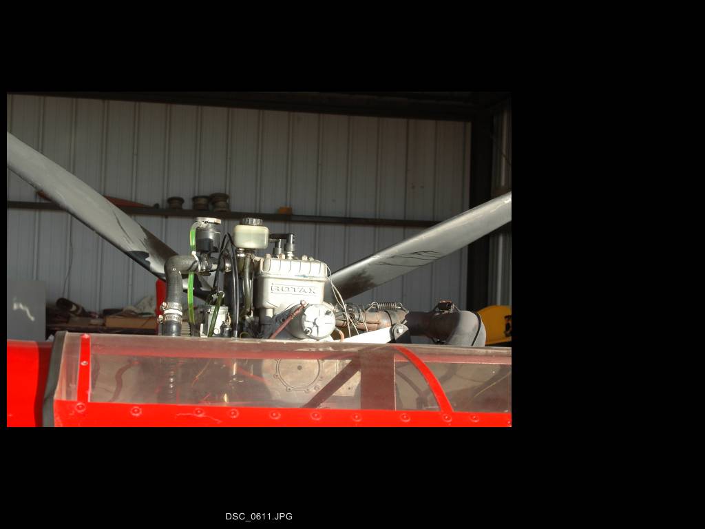

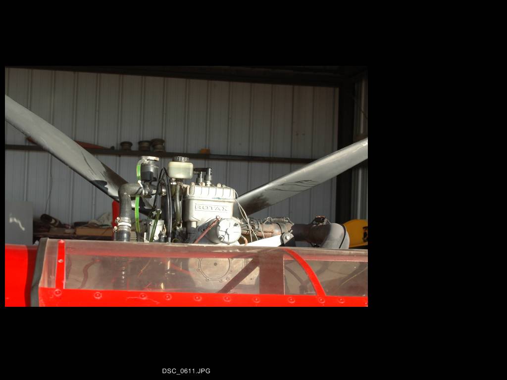

Still a bit of oil spray on prop, apparently from behind the front carb on the 532. Just replaced the gaskets at about 95 buck s a whack each and think I have em tight. Oil appears to be from one of the little mystery hoses there. Again, open to ideas of getting this thing good to go. Did replace the muffler gaskets, and didn't put any sealant on them. Ones I removed that were really leaking looked okay. Wondering if there is slight warp that may have occurred in past.

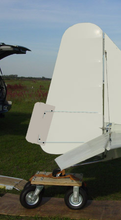

Not sure from whom/where I got the recommendation for attaching the fixed trim tab, (CRS) but I do remember that it was from a respected source.
Mine spans the bottom two ribs in the rudder (not the bottom edge). This puts the vertical center of the trim tab at about the horiz stab. In the construction of the rudder, the ribs are bent at the rudder trailing edge into 'L' shape, then riveted to the TE. The rudder trim tab was made of sufficient size to be able to rivet it to the ribs a couple of inches forward of the TE and in the 'L' where it connects to the TE. I did not rivet it to the TE. Have attached a picture of the rudder showing the approximate set up for the trim tab and where it is riveted. The blue lines are the rudder ribs and the dots show the rivets. (The picture was actually taken before the trim tab was installed. I have modified the image to show the approximate setup.)

Would agree with your A&P re: fighting the rudder. Too much trim. Take some of the angle out.
<<<SNIP>>>
jsf
My guess is that your "little mystery hoses" are overflows from the carb bowls. Check carb alignment to ensure that they are level particularly if you have had the carbs off replacing "gaskets".

Just tuned in to your message, don't know how far you are into checking for sure what is on the prop.
Bing's will let fuel overflow from the small vent line if the float is set to high or if the valve is not sealing completely.
Just out of curiosity have you given the substance the good old taste test? Sweet or not?
Oil vs coolant.
Just a thought.

If you do not have strong return springs on your pedals then you can expect the rudder to flutter if you remove your feet. In my case, there are no springs, instead there is a return cable loop. It works well but if you take your feet off the pedals you can expect a flutter to start soon.
Also, when Bryan Melborn builds Fireflys he always puts the same tab on the rudder from the get go. According to him it works every time. When he recovered my Firefly he puts his standard tab on the rudder and it work perfectly.
