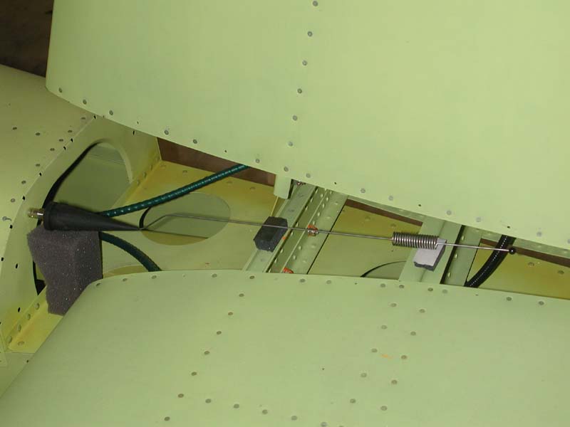

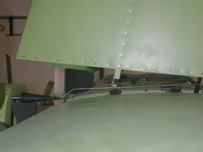

PostPosted: Wed Oct 04, 2006 3:07 pm    Post subject: hugo rv10 Reply with quote
Thanks again for the answer,but personaly never purchase cheap tools,use few times but allways do perfect job.
Now my next question.
ELT antenna,in a 180knots airplane I thinks a flexible spring antenna will be out of question ,I belive can't be mount inside an a aluminum plane,I found a spot under the vertical stabilizer ,the 10 use a thin fiberglass fairing,what you guys thinks will work?,.eventualy need to work only one time,in a shallow accidents probably don't needed but in a bad one ,the the antenna will be pointing up and almost at the highest point,(sorry for the humor)
here the pictures ,
thanks again ,Hugo
