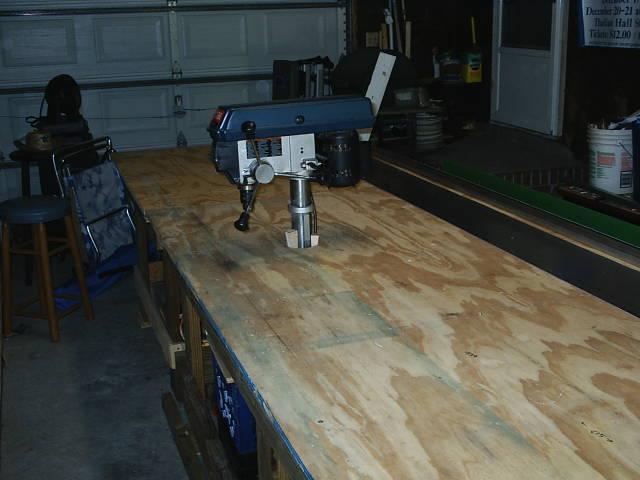

Hi guys,

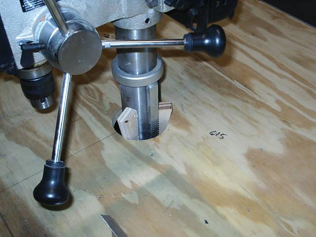

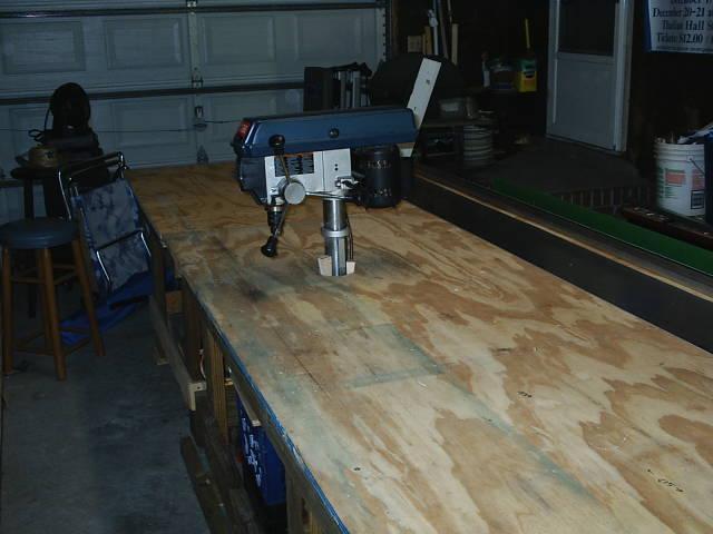

Ever since I started thinking about drilling my spar caps, I've been scratching my head about the best way to drill perfectly aligned holes into them and still support the remaining ends so no bow is built into the spars. I've seen where other guys set their drill press beside their work table and swing the head around, and I even tried it, but it was a little like driving a car from the back seat. It was hard for me to make sure everything was perfectly aligned, and for this critical drilling operation I felt like I needed to be a little more in control.
Here's my solution. I used one of my hole saws to cut a hole in the workbench so I could stick the post of the drill press up through it. The head of the drill press comes off with two simple allen screws, so it was really easy to remove it, then stick it back on. The drill press is resting on a solid small table under the bench, and I've even got the normal adjustable drill press table cranked up and braced against the bottom of the workbench - further stabilizing it. After leveling and making sure everything was square, I cut some small wedges and wedged the post in the hole. It's solid as a rock.
After I'm done drilling, I can remove the press and will be able to put a c-clamp through that hole and clamp things from the middle of the table. Pretty cool.

PostPosted: Sun Oct 01, 2006 8:20 am    Post subject: Scratchbuilders - Spar Cap Drilling Idea Reply with quote
Debo-
I used a roller support and C-clamped a 2'x2' piece of plywood to the drill press table. Then again, I'm lazy.

PostPosted: Mon Oct 02, 2006 3:30 pm    Post subject: Re: Scratchbuilders - Spar Cap Drilling Idea Reply with quote

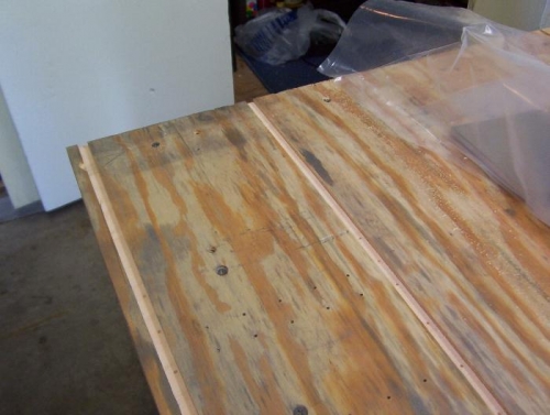

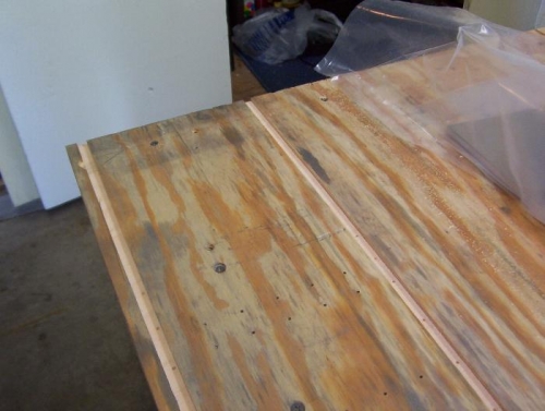

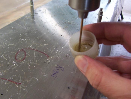

I did a little thinking here also, and figured the work table is real flat and stationary. Now what would be an easy way to move the part past the drill press? Here is what I did. Out came the router and I cut two long groves the length of the table. These are so the clecos don't snag when moving the parts. Next the visqueen goes on the table then the part goes on top of that. It slides real smooth and doesn't leave scratches.

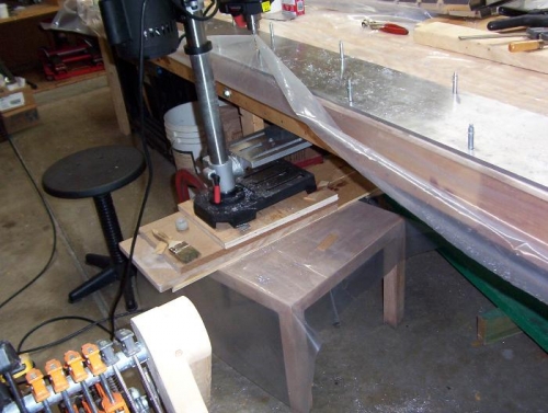

After hand drilling a few holes to get the Rear Spar Caps clecoed in position, the Web is the drill template, position and square up the drill press. The drill press bed is cranked up to touch the lower beam of my work table. Helps steady the whole setup. I placed a 1" piece of black rubber on the movable drill press table and cranked it up and locked it in place, then check for movement and squareness. Had to try a few shims and a C-Clamp but it is square and stable. I just used enough up pressure to compress the rubber a little and not lift the work table.

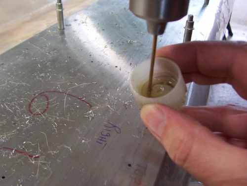

In a top from a squeeze bottle add some Tap Magic, dip drill bit before drilling each hole. I should be able to match drill everything as a stack with this setup. All the pilot holes are in the webs and spar caps for the wings.
