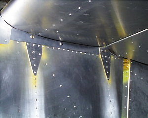

craig(at)craigandjean.com

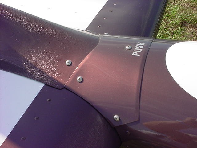

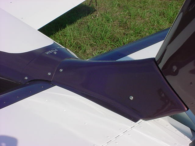

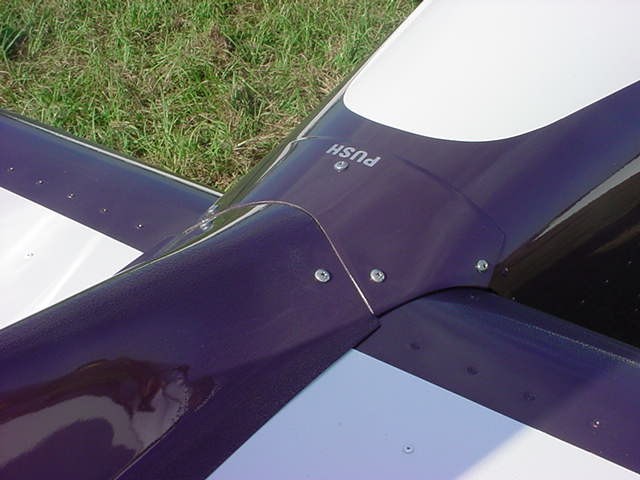

PostPosted: Mon Oct 02, 2006 12:15 pm    Post subject: Stupid question: mounting the horizontal stab. Reply with quote
This is what Zenith had to say about my problem.
-- Craig

VideoFlyer(at)aol.com
PostPosted: Mon Oct 02, 2006 1:59 pm    Post subject: Stupid question: mounting the horizontal stab. Reply with quote
I've wondered, too, about mounting the stab after the top rear skin has been riveted. The mod in the pictures looks pretty slick.
A really neat solution would be for Zenith to redesign the fiberglass piece that fits on top of the stab under the leading edge of the rudder.  Is there any reason why it couldn't extend all the way up to the rear bulkhead?
Dave Harms

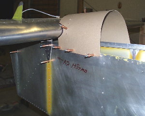

entecrj(at)sbcglobal.net

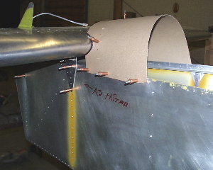

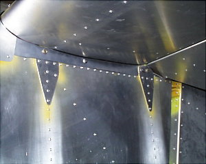

PostPosted: Tue Oct 03, 2006 5:24 am    Post subject: Stupid question: mounting the horizontal stab. Reply with quote
riveted. Dave Harms
601XL/Corvair
By notching the top fuse skin, the horizontal stab can be installed later.
As shown in the attached photo, make a cardboard template before cutting
metal.
R. Johnson
601-HDS / Corvair
(putting the engine together)

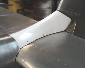

larry(at)macsmachine.com
PostPosted: Tue Oct 03, 2006 8:02 am    Post subject: Stupid question: mounting the horizontal stab. Reply with quote
Craig,
I've included a linked image from when my stabilizer was being fitted
and had much the same problem. I made my saddle reach a bit more to
minimize the
tail skin overhang needed to get the stabilizer to slip under and on. I
ink marked nearly 3/8-inch clearance around the nose to get the stab to fit.
http://www.macsmachine.com/images/rudder/full/fibrglasfairing.gif
http://www.macsmachine.com/images/rudder/full/rudderfairing.gif
Larry McFarland - 601HDS at www.macsmachine.com
