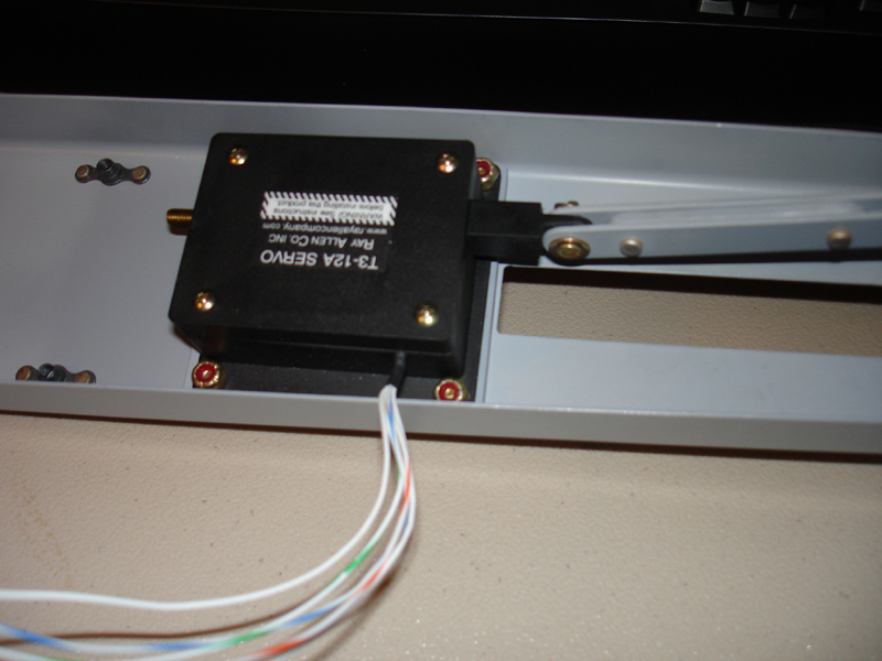

Was wondering if anyone else had this problem or not?
Before I mount the elevator trim servo bracket with the Ray Allen trim servo, I wanted to
think about the wiring. The wires make a real sharp bend due to the closeness of the mounting bracket.
See attached picture. Did anyone cut out a half circle in the bracket or just bend the wires and
cover with protective material?
Also, what wire did you guys use to hook up the servo?
I was thinking of ordering the WC2 5 wire Teflon Installation Cable from Ray Allen
at $1.10 per foot.
Thanks for the input

I left the sharp bend in mine, but the half circle is a good idea… There’s definitely enough structure to support cutting such a small relief for the wires.

I can't recall cutting the bracket but for wiring you might consider a shielded quad and a shielded pair of 22G wire. probably less expensive that the trim cable and shield can be grounded on one end if there are stray electrons running around in your airplane. Come to think of it I bought the cable and decided not to use it.

I drilled mine for a small hole and inserted a snap bushing so the wires come out of the side. Just drill the hole in the center of the side metal so as not to weaken it.
