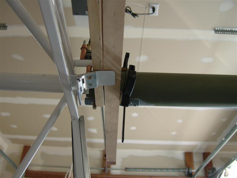

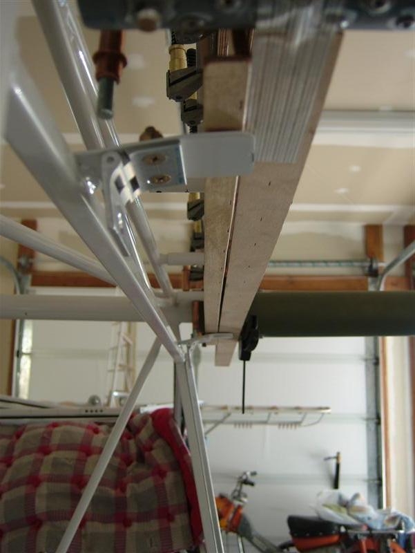

I am installing the butt ribs on my 7 and have run into something that doesn't quite look right. Here is the situation:
When I position the #1 rib on the wing then allow for the 1/16" between the #1 rib and the butt rib, the rear butt rib tab (welded to the upper member of the door frame on the fuselage) does not have enough clearance between the hing bolts and the butt rib flange to allow for the rivets. The front tab is just fine with plenty of room but...I am installing a 912S so I am not putting in the 1 degree of sweep and have measured and remeasured from Rib #2 to Rib #1 and am absolutely sure I have the 34 1/2" required for the fuel tank at the leading and trailing edges. I have attached a couple of pics to help with the explanation...I this what I should be seeing and if so, what should I do about it?? If this doesn't look right, what might my problem be? These are factory rigged wings and I did not modify anything from the factory settings. I should say that I am using the aeroplastics bubble doors that are 1/8" thick so my hinge is spaced a tad bit more away from the fuse to allow for clearance, but I need around 3/8" to get the rivets into the flange of the butt rib.
Any ideas?

This is a little blurred, but I put a yardstick in there at the same time to maybe help...
This is the rear of my left butt rib. You can see the two rivet heads holding the butt rib to the tab, and the two holes in the tab for the rear door hinge. I can't take the same picture angle as you because that would be straight at my celing light, and if I turn it off there is too much glare from my camera flash... sorry.
I have the factory rigged wings, swept forward (although the difference on the rear tab should be negligible). The holes in my front tab look pretty similar to yours. The rear one, well, I'm not sure why yours isn't coming out. from the edge of the "B" pillar (vertical square fuselage tube that forms the back of the door) to the center of the rear through-bolt (that holds the rear wing spar to the fuselage) is about 1-1/4". From the edge of the #3 rib (the one next to the fuel tank) to the center of the rear through-bolt is 36-1/8" (left wing) and 36-1/4" (right wing).

Judging from your photo, your butt ribs ended up at exactly the same position
in relation to the rear hinge & rivets as on my model 7 - which did not have
the quick build wings.
Here is what is important.
1) The wing ribs have to be in the exact place that the measurements put them
- quick build or slow build should be exactly the same.
2) The spar bolt holes are fixed in relation to the end of the spar, since the
ribs are fixed in relation to the spar, Rib # 1 is going to be where it is
going to be.
3) The butt rib must be adjusted to fit 1/16" from rib #1 to allow room for
the fabric
Remaining options? - unscrew the rear door hinge, put the butt rib rivets
under the hinge and either fabricate a spacer or relieve the back of the
hinge so the rivets don't hold it off the tab. A person may have to relieve
the inside of the butt rib to make room for the rear upper hinge nuts.
At least that is how mine worked out - doors fit fine, so do the butt ribs &
the hinges work smoothly.
