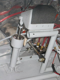

Does anyone know where to get a valve block to use for a parking brake on a
601XL? The attached picture is what I think I want but it is of Dragonfly
Aviation's plane which has dual brake pedals. My plane has the standard
single set of brake pedals.

I'm installing the Matco PV-1. It's in Aircraft Spruce catalong and looks
like the one in your picture. $100+ as I recall. I'm putting it on the
firewall, opertated with a Bowden cable. It has 1/8 NPT female, two inlets
for the two master cylinder lines, and two outlets for the brake lines.
Robin in AR

Robin: I put the same valve on the firewall and what a hassle to bleed the brakes. In order to get the bubbles out of the valve I have to break the connections at the valve. If doing it again, I would keep the valve on the floor and keep the lines running uphill to the pedals. Jack in Los Osos CA

Yup, that's the one: Matco Parking Brake Valve 06-17200. Vans also sells it
on their site.
