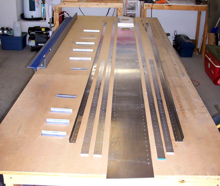

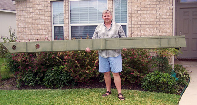

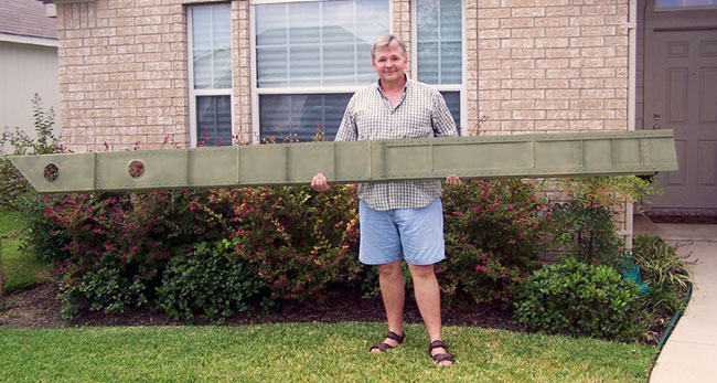

For all you scratch builders who are intimidated by the prospect of building your spars, I have good news. It isn't that hard. I finished my right spar today. With the lessons learned from that experience I figure the left one will take 1/3 the time to complete. Special thanks to David Barth, Randy Bryant, and Herb Heaton, who all crossed this bridge before me. Their advice was invaluable. Also thanks to Debo Cox for helping me figure out a way to bend my spar cap angles. And of course, thanks to Mr. Scott Laughlin for always answering my stupid questions.
