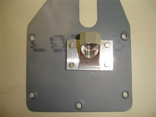

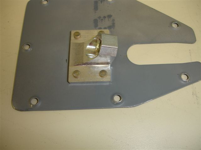

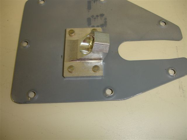

PostPosted: Sun Sep 17, 2006 4:30 pm    Post subject: Re: Safety Alert WD-415 weldment Reply with quote
Guys,
Deems has a few pics of the trim tab weldment on his web site at
http://www.deemsrv10.com/album/CNC%20Parts/index.html
Also, I included a couple of pics of the part already mounted on my trim tab cover.
Zack

The all aluminum (after kit market) parts are MUCH thicker, more threads to grip, no weld to break (or adjacent weak metal) and have a much more solid base that will accept a countersink and allow the cover plate to be dimpled and flush riveted. This is a no brainer to buy the part for a few bucks and get peace of mind and a better part.
