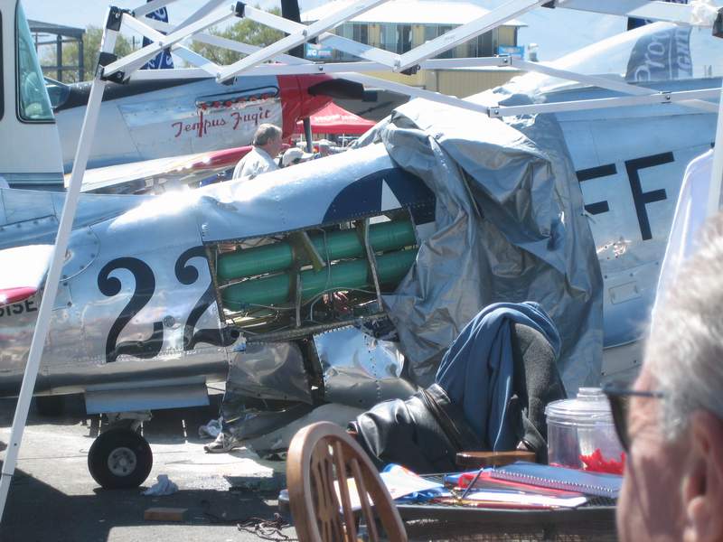

Ben mentioned the oxygen tank explosion at Reno. I was shooting video of his team's gorgeous Grumman Tigercat when I heard the big boom. The picture below shows what that does to a Mustang.
Jill and Carl at M-14P can now do your hydrotesting. The turnaround is fast and they won't ruin your tanks using the wrong fittings.
| Quote: |

I heard third-hand that it was a case of improper filling, not necessarily a problem with the tank. There has been much discussion here in the past about where to get hydrotesting and the lack of shops familiar with our tanks. That is no longer a problem.

As I understood, it was over pressurized by using the wrong scale to the
tune of 1800 psi, if I heard correctly. Strictly rumor and inuindo at this
point.

One of my YAK-9 buds was about 50 feet from it when it let go at Reno. It
was filling it to the wrong pressure that did the tank and the ass end of
the Mustang in. Luckly, no bystanders.

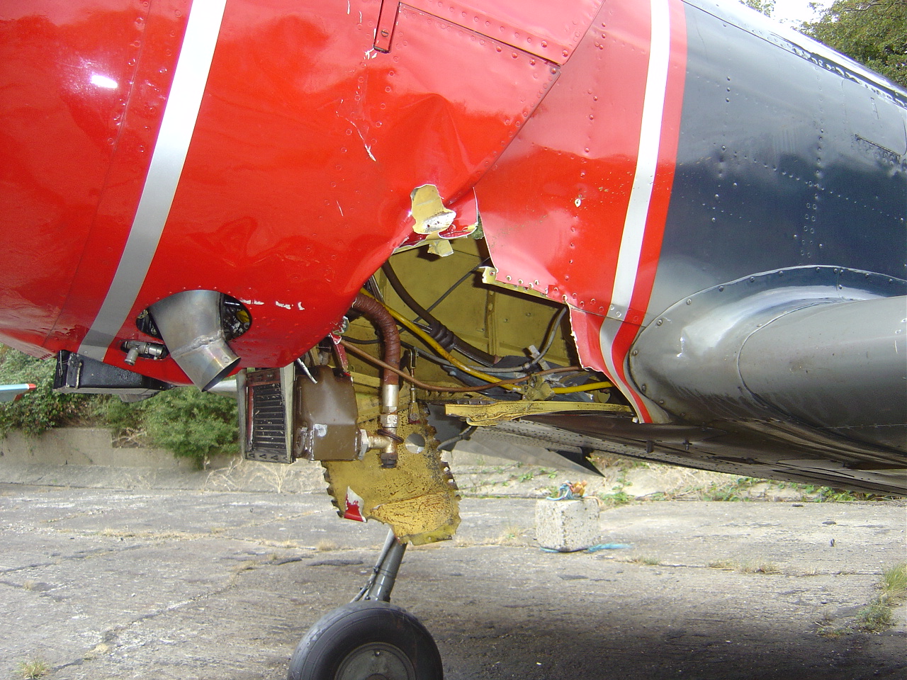

Posted: Thu Sep 21, 2006 12:01 am Post subject: Oxygen Tank Explosion, Hydrotesting |
Yak air tanks can be lethal too !
This one let go on the ground during warm up.
Keep em tested !
kp

The tank exploded because it was over pressurized. It was an original type tank, which is low pressure and rarely used today.
The important questions are:
from the aircraft owners point of view: WHo allowed it to be filed w/out checking/confirming what was going in
from the maintainer's view: How did someone come to be filling a tank without know for certain the type of tank it was.
