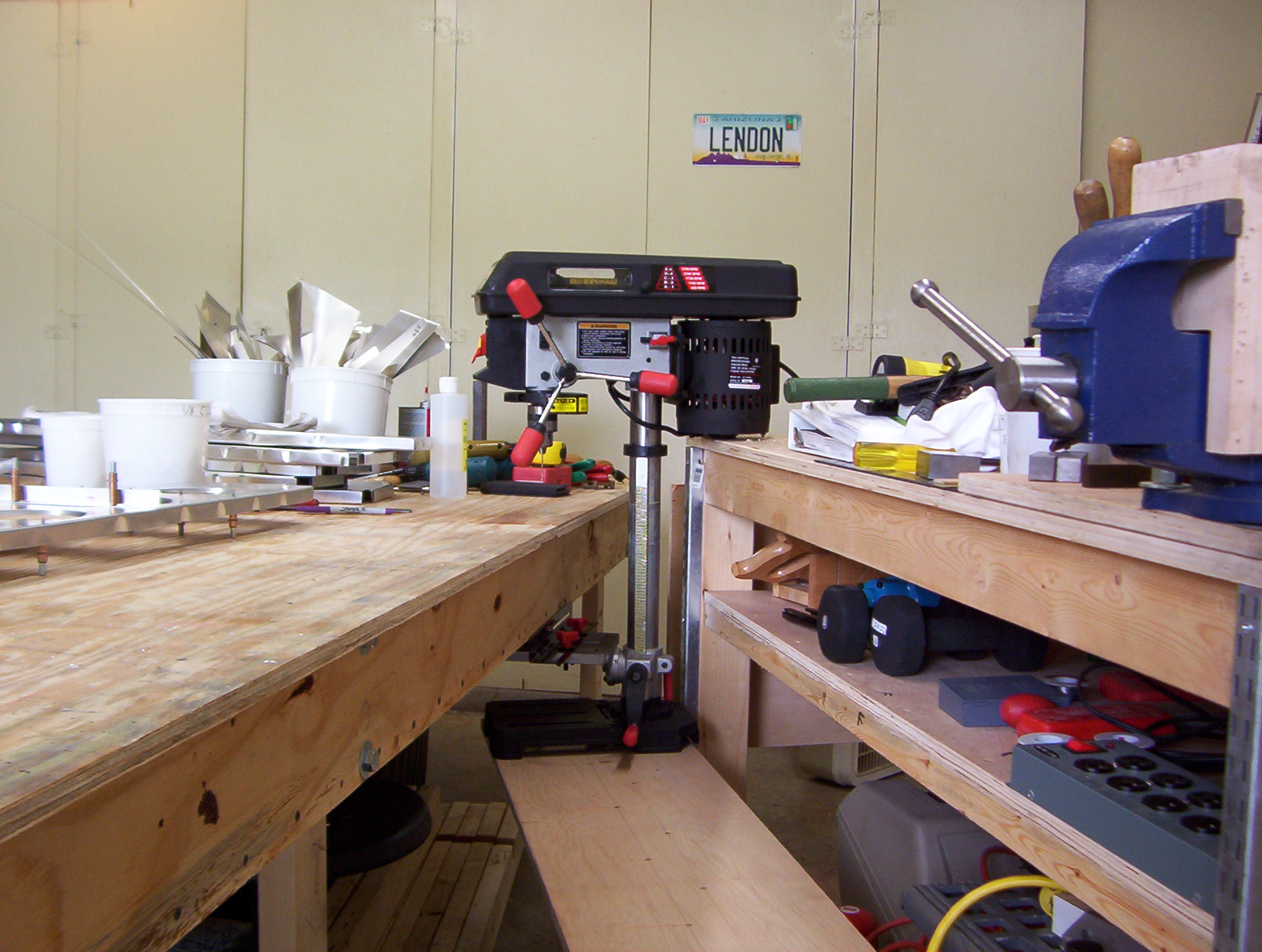

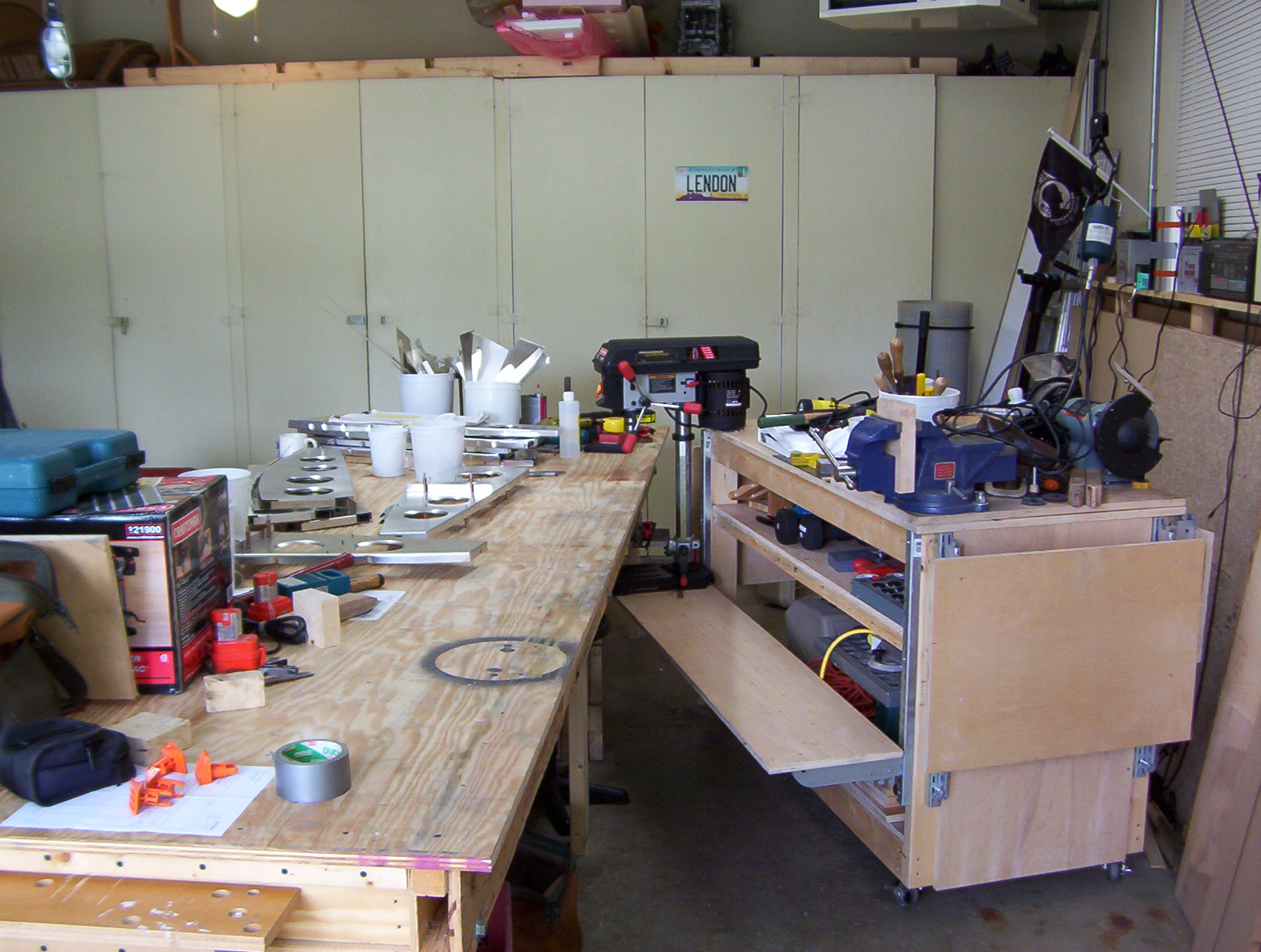

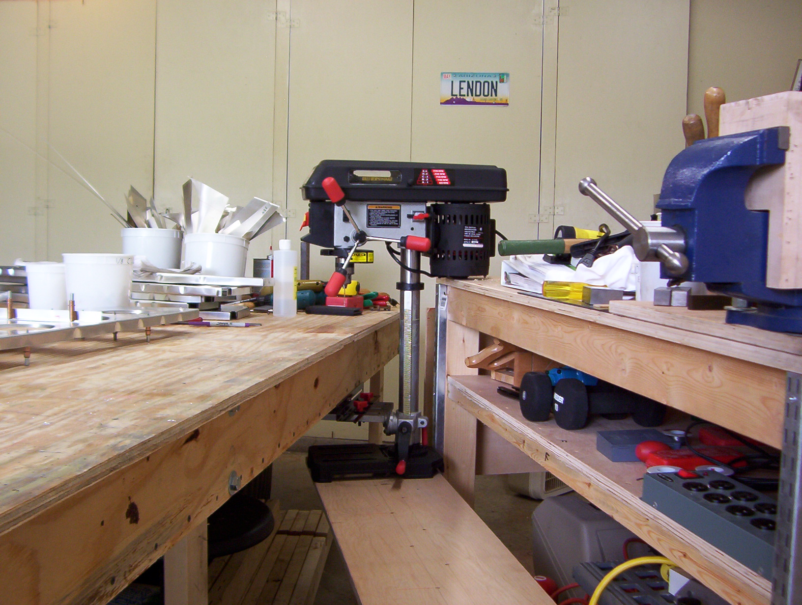

I am heading in the same direction as you. One Idea I had was to tram (square up) my drill press spindle to the table top. What I mean here is to invert the base so the spindle can reach the table top and move the spar along the table while drilling. That looks like the easiest way to keep it supported while drilling.
Below are 3 pictures of my shop, table & workbench. The workbench has adjustable shelves. Looks like I may not have to invert the base because it fits under the table. I may have to use several positions, and tram in the spindle at each location.
Carlos, what do you think?
Little closer shot. Base fits under table.

Shot of the workbench with the drill press lowered for table top work.
