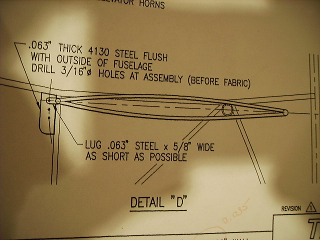

I've been working on the empenage, and have a few questions:
In the AS&S plans, page 7, detail D shows the upper inboard ends of the stabilizer is about 3/8" Above the upper longerons. I've been puzzled by this, and haven't been able to see it clearly on any finished planes. It doesn't make much sense, because it would add a little bit of drag.
The 1 X .035 horizontal spar is saddled up in the V at station 163.  My eyeball engineering sees this as a weak way link, and I'm wondering if I should add a gusset here. At this point I have the spar just tacked in, but if I lower the horiz stab spar and add gussets, I should be able to keep the upper inboard ends of the stab below the longerons, and eliminate the interference between the elevator con rod and the diagonal piece. Waddya think ???
It has been suggested to keep the inboard ends of the stab a tight fit against the fuselage. Last evening, I braized the 3/8" ribs on the stabilizers, and now the leading edge of the stabs has increased in length, and leaves a gap between the inboard ends of the stab and the fuse...now I have that to deal with - what to do ?
Acording to the article by Jim Stanton - 'Looking for SPEED', (T.T. # 7) I've incorporated the 'Shield' on the stab, in front of the Counterbalance on the elevators.

Leave the stab. spar in the V where you have it. The top of the inboard 3/8" rib will be slightly lower than the top of the longeron. That is where it should be.
If the leading edge is to long at the front mounting area, cut it off and remove whatever is necessary to make it fit and reweld it. Jim C

rjrellis(at)yahoo.com
PostPosted: Sun Oct 01, 2006 4:39 am    Post subject: Stabilizer Location Reply with quote
Chuck,
I think this is the picture you are referring. Perhaps
the photo attached will help others understand what
you are talking about in regard to the stab and
longeron positioning. rle

Rcaprd(at)aol.com
PostPosted: Sun Oct 01, 2006 9:58 am    Post subject: Stabilizer Location Reply with quote
In a message dated 10/1/2006 7:41:55 AM Central Standard Time, rjrellis(at)yahoo.com writes:
Yes, that's it. The thing is, the butt line of this intersection between the stab and fuse is at a slight angle, not in line with the slipstream, which will add drag. On the other hand, this is in an area of a lot of turbulence of the prop wash, and it may not make any difference - other than it just don't look right.
Chuck G.

<?xml:namespace prefix="v" /><?xml:namespace prefix="o" /><![endif]--> Chuck, I agree with Jim, a piece of filler won't hurt, just don't try to weld all the way around the spar as it could weaken it. I have a set of Steve Wittman prints and he made everything "bone simple" and also vague, which leaves room for modifications of your own as long as it doesn't interfere with structural integrity. I've found that when a problem occurs just ask on the forum site and out of all the responses you get you should be able to come up with a plan. Most everyone has encountered the same problem at some point and that is why I put a lot of trust in what a lot of the "old hands" (builders not buyers) have to say. Still making mistakes and still correcting.
Alex
- The Matronics Tailwind-List Email Forum -
http://www.matronics.com/Navigator?Tailwind-List
jclement000(at)centurytel
PostPosted: Sun Oct 01, 2006 12:44 pm    Post subject: Stabilizer Location Reply with quote
In that case I would move it either forward or back an put a filler in the gap side.
Rcaprd(at)aol.com
PostPosted: Sun Oct 01, 2006 4:43 pm    Post subject: Stabilizer Location Reply with quote
In a message dated 10/1/2006 3:45:21 PM Central Standard Time, jclement000(at)centurytel.net writes:
Thanks so much for your help, Jim. Like Alex mentioned, I too follow the advise of experience. That's what makes these forum's so valuable.
Chuck G.
