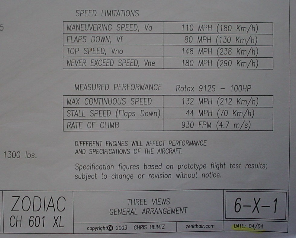

This question is for people that have built, or are building, 601xl's. I was looking at Zenith's website for the speed range for operating the flaps, but could not find it. Does anyone know what the speed range is for the flaps?

I don't have them in front of me but as I recall the speeds are listed on one of the first few pages of the plans you would have got from Zenith.

bryanmmartin
Posts: 1018
PostPosted: Sat Sep 16, 2006 5:11 pm    Post subject: speed range for flaps Reply with quote
Thanks for your help,
Randy Ferri
601xl  Jab. 3300
I recieved this file in reply to an email I sent to ZAC, It lists a Vf of 80 mph:

PostPosted: Sat Sep 16, 2006 11:56 pm    Post subject: speed range for flaps Reply with quote
I have mine placarded (white arc) to use flaps below 80 mph indicated. I regularly deploy them at that speed, and have never had a problem.
