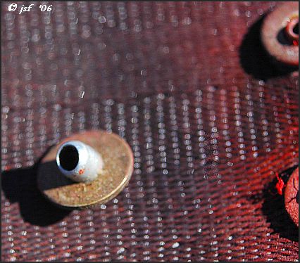

A few hours ago, I found a potentially deadly situation in the red renovation.
Replacing the old seatbelts, I was about to cut off one of the red overspray painted belts. I flicked the head of this rivet, it came free and that was it. That seatbelt on the pilot's side had ONE pop rivet attaching it (and me) to the airframe. The other belt on pilot's side was 100 percent better. Two pop rivets...!
I would dearly like to find that person who set me up for potential life loss. So if you are purchasing a Kolb from anyone, please go over it with a fine-toothed comb and with the eyes of a couple of other people.
jsf
