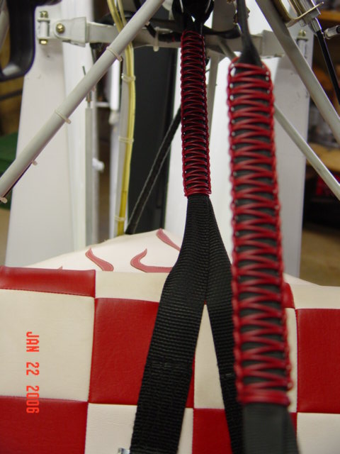

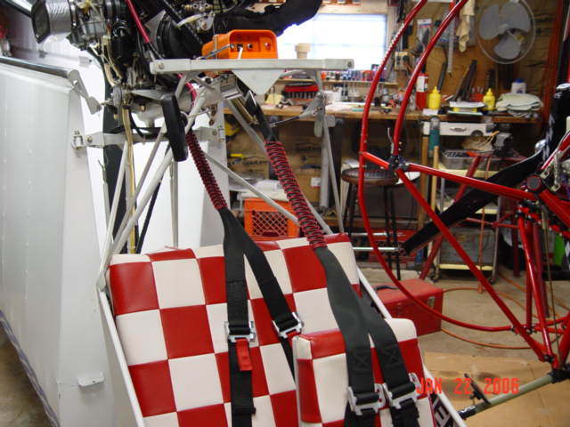

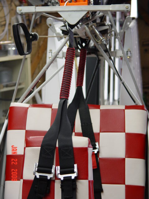

Hey Guys,
I've seen this "cure" before.....This is MY version ....
I took some elec wire, Red to match my plane...and I macreme'd the shoulder strap.....I need to leave them loose when I fly , so I can lean forward and reach the ignition ( Cessna too , but for "BOTH" fuel )
Anyway, I had a little trouble with the straps sliding off ......not now.
Gotta Fly...

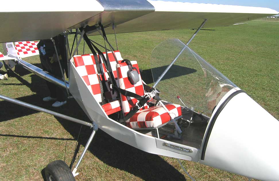

Hi Mike,
Either that is the worlds biggest shop fan, or you are flying a powered parachute, or trike. Do you still fly that thing, or do you like the firestar so much that it just sits ? Lets see more pictures of your entire plane, the red checkerboard looks pretty cool.

PostPosted: Sun Jan 22, 2006 3:54 pm    Post subject: Re: plane pictures Reply with quote

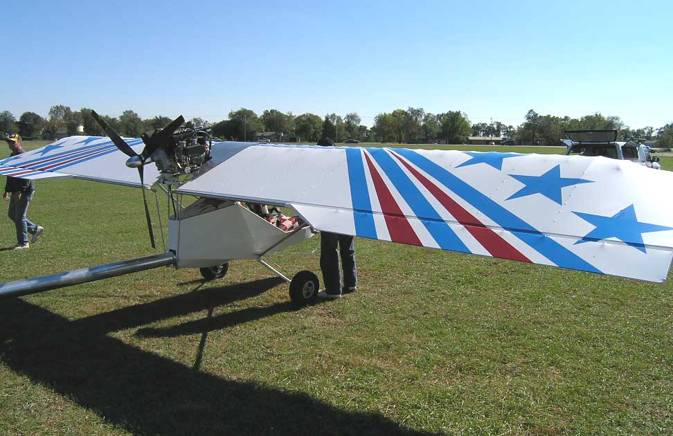

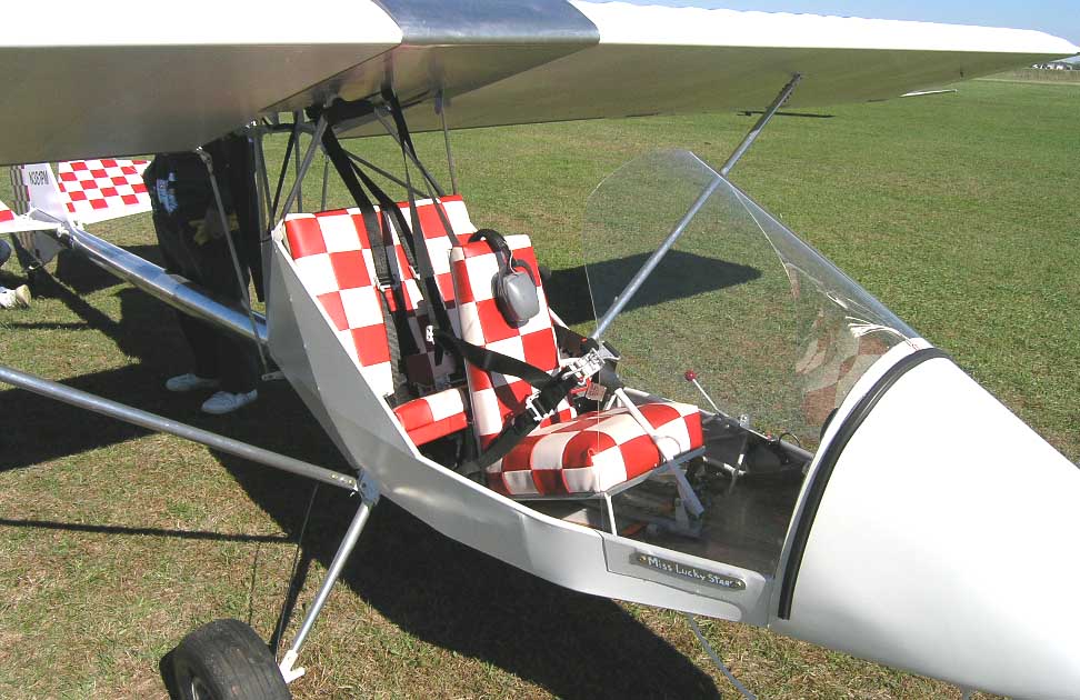

He's some Pic's.... Ralph took these pictures the day of my First Flight...
Oh, the"FAN" is a Buckeye Powered Parachute,Dream Machine,2 seat
582/ 3 blade IVO , For Sale - $8,000

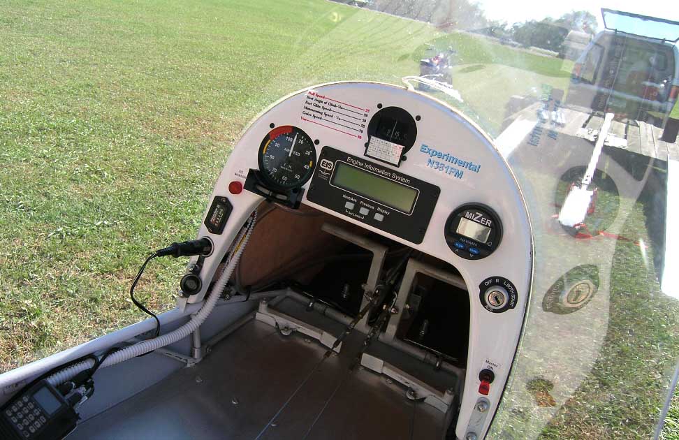

PostPosted: Sun Jan 22, 2006 5:58 pm    Post subject: Re: Shoulder straps too loose Reply with quote

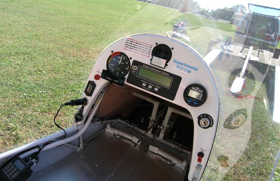

Nice looking plane Mike. The professional lettering on the panel is a nice touch, how did you do that ?
What is that guage called the miZer ???

PostPosted: Mon Jan 23, 2006 3:29 pm    Post subject: Re: Shoulder straps too loose Reply with quote
Hi,
The "lettering" on the dash is done with my computer, then "taped" in place..... One is my "N" number.... on the other side are my "V speeds"
And I put "Stall" and "VNE" in RED
I also labeled all the other stuff that way for my airworthiness inspection.
I used the WIDE clear tape, so it seals it , and looks better...
The Gauge that sez " miZer " is my Fuel gauge/fuel flow gauge, and it has an alarm ( at whatever gals "left" I program )
It was a litte SPENDY at $300 bucks from A.S.&S.
