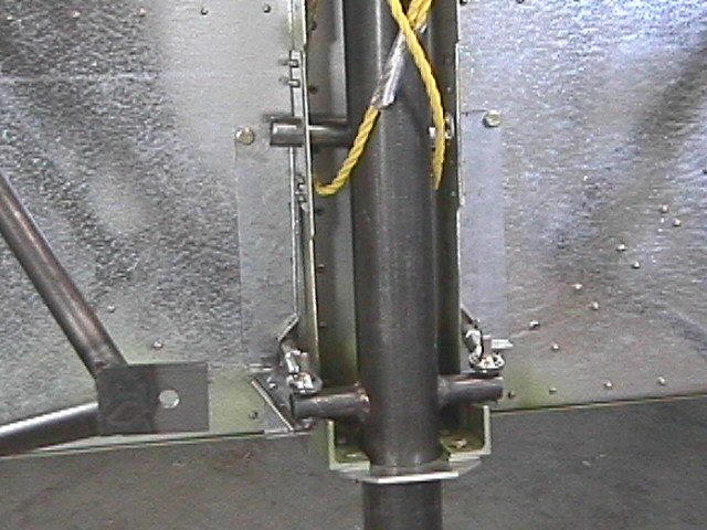

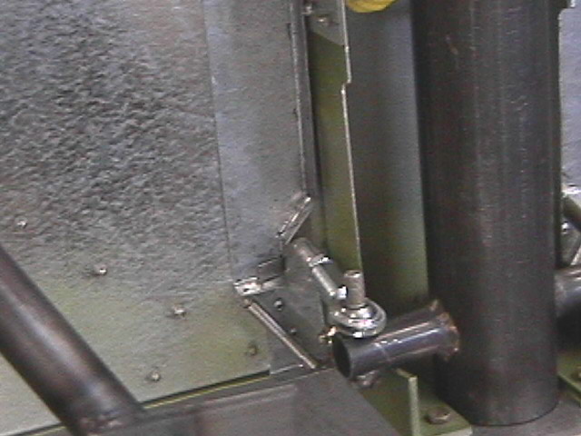

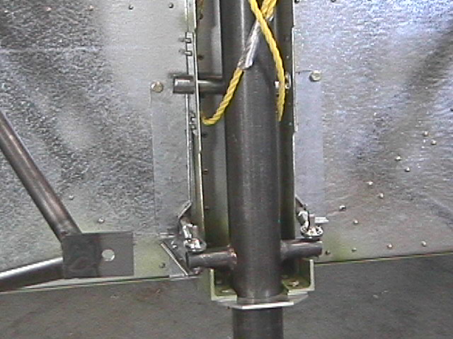

Jay,
I used a method without boots. I explained it before but here are a couple of picture. The important thing to remember is the rods don't have to be sealed until you are flying, if it leaks air while you are on the ground it doesn't make much difference. As you can see they are just two little doors that close when the weight is taken off the front wheel. To eliminate the noise of the threaded rod I found a piece of thin wall aluminum tubing in may stash of junk and slid them over the rods held in place with a couple of nuts.
Tim Shankland
